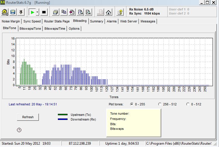

Can you post the following information - ADSL Line stats from your modem/router (see here - select FAQ's and Troubleshooting and View More on your DSL connection, or here , for guidance if you don't know how to get them), the Results from a BT speedtest (diagnostic) and your Current Line Speed (login required).

Re: very poor service and a warning re 21cn "upgrade"
20-05-2012 7:42 PM
Mode: ADSL_G.dmt.bis
Traffic Type: ATM
Status: Up
Link Power State: L0
Downstream Upstream
Line Coding(Trellis): On On
SNR Margin (0.1 dB): 61 51
Attenuation (0.1 dB): 725 447
Output Power (0.1 dBm): 0 129
Attainable Rate (Kbps): 1420 416
Path 0 Path 1
Downstream Upstream Downstream Upstream
Rate (Kbps): 960 444 0 0
MSGc (# of bytes in overhead channel message): 59 10 0 0
B (# of bytes in Mux Data Frame): 30 63 0 0
M (# of Mux Data Frames in FEC Data Frame): 4 1 0 0
T (Mux Data Frames over sync bytes): 1 1 0 0
R (# of check bytes in FEC Data Frame): 10 0 0 0
S (ratio of FEC over PMD Data Frame length): 4.0 4.5309 0.0 0.0
L (# of bits in PMD Data Frame): 268 113 0 0
D (interleaver depth): 8 1 0 0
Delay (msec): 8.0 1.13 0.0 0.0
INP (DMT symbol): 1.19 0.0 0.0 0.0
Super Frames: 18152200 538075 0 0
Super Frame Errors: 0 0 0 0
RS Words: 294973264 0 0 0
RS Correctable Errors: 1681465 0 0 0
RS Uncorrectable Errors: 80888 0 0 0
HEC Errors: 4294967295 8794 0 0
OCD Errors: 0 0 0 0
LCD Errors: 0 0 0 0
Total Cells: 667841720 516720 0 0
Data Cells: 8339319 4784 0 0
Bit Errors: 0 0 0 0
Total ES: 19120 4294967293
Total SES: 19 0
Total UAS: 152 4294967240

OK, capped uploads - some users have reported stability issues when having the upload uncapped, so that is always worth considering. It can sometimes come at a small expense to download speed if more bandwidth is allocated to upload, so if you don't need fast upload speed it may as well be capped.
The Netgear may have had a slightly different bits per tone allocation when you tried it which may account for the different errors. You can update the firmware to make it ADSL2+ compatible. I'll see if I can find the links. It wouldn't be a bad idea to check that you've got the latest firmware on each of your modem/routers.
