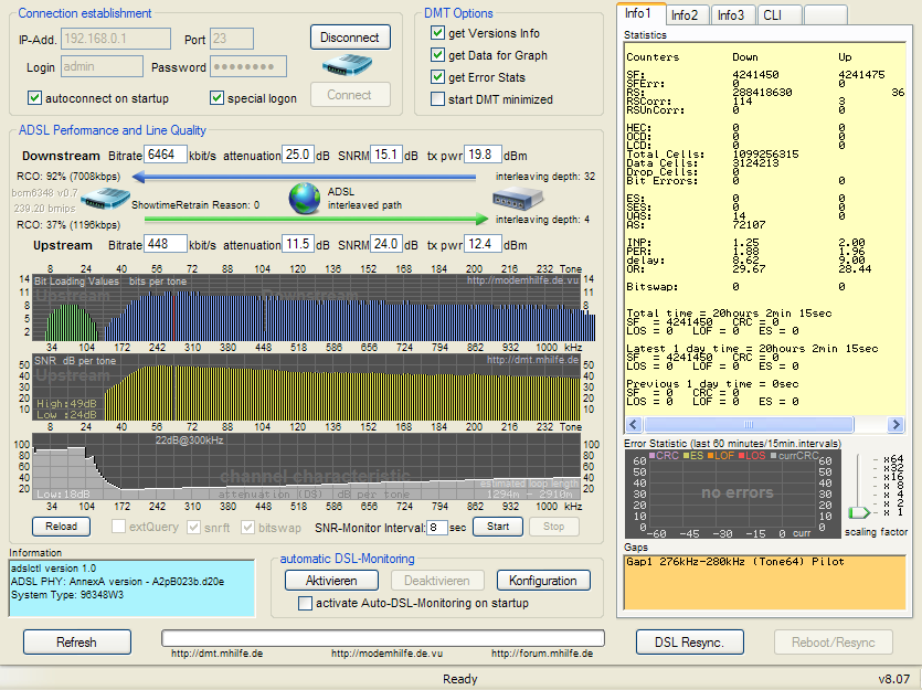

Quote from: Catweazle
but the DMT graphs are still looking encouraging.
The error figures certainly are. 114 RScorr is the only thing that went wrong, and they got corrected.
It should cope well with the SNRM being turned down.
Comparing the differences between the graphs, you can see that the yellow bars don't seem to change at all.
The blue bars alter slightly, so there's a little bit-swapping going on.
Definitely looking good  Cheesy

It's still looking good - I asked for the SNRM to be reset yesterday and it's now settled around the 8.8Db mark with a sync rate of 8128kbps  Smiley
The IP profile needs to catch up, though - it's still 5500kbps
Latest DMT graph is attached.

Your SNRM will probably stay around that level, which is good, as you're at the maximum speed with plenty of "headroom" left.
So it should stay stable now  Grin

Excellent-looking graphs, very good error figures, and what looks to be perfect noise & sync values. I'm pleased the end result seems to have turned out so well, but didn't it take some work persuading BT?
