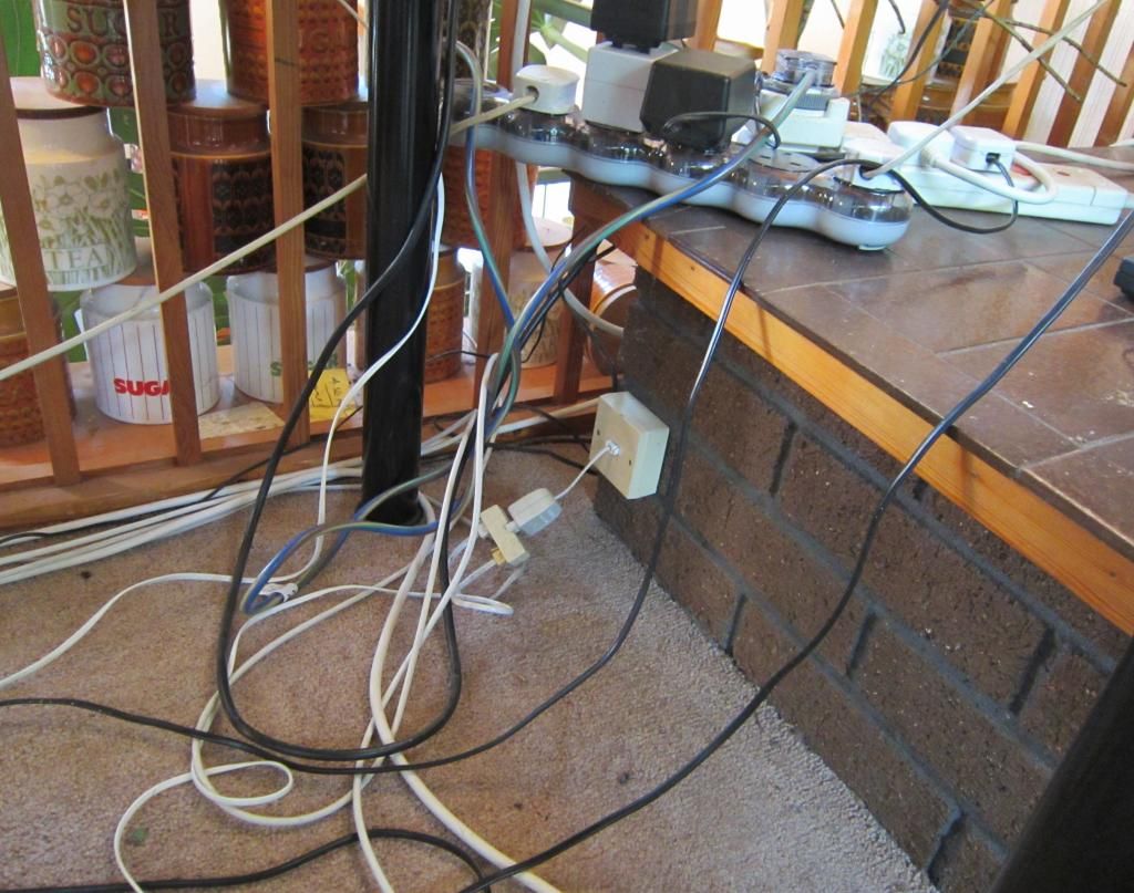

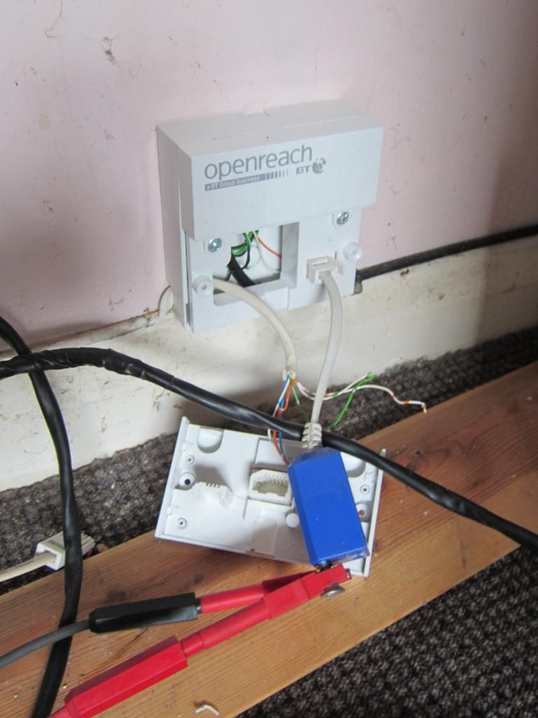

Warning - this posting contains images of horrendous wiring - view at your own risk!    Shocked
The master socket is very inconveniently located just inside the kitchen door remote from any mains sockets. Here's the installation in progress. Wire coming in from pole on the right, extension wiring going off to the left:

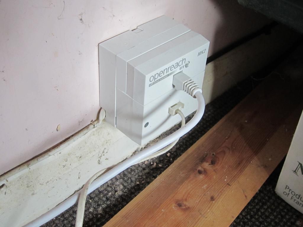

And here it is completed - the phone plugged in here is my "emergency - for use in a power cut" one - since there's a cordless one in the kitchen too:
The router is located at near first floor ceiling level plugged into the master socket via a good quality 10m long cable.
Here's the other end of the extension, which was already installed when I bought the house 18 years ago and which appears to have been done professionally:
Now I do realise that's rather untidy! The extension is serving (a) a fax machine which I also use as an answering machine and (b) an extension lead leading to the main phone basestation. The house has a paucity of electric sockets - there's only 3 doubles in the 8x4m sitting room. Hence extensions everywhere. The multiple at the back serves three further multiples: the one shown which times the internal lights on this side, one on the desk above (which serves the router), and the one in the next picture.
The engineer looked at this area and didn't suggest I'd need to tidy it up - his advice was to rewire the extension but he did mention electrical interference.

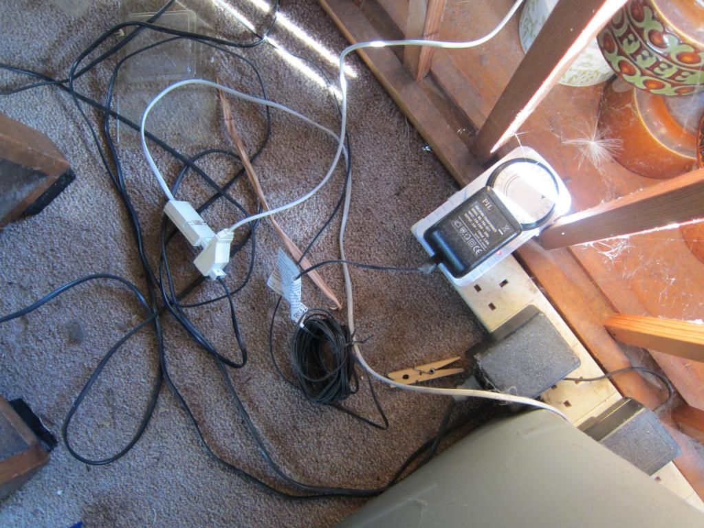

Here's the other end of the phone extension wire:
The main phone basestation is here and then there's yet another phone extension plugged in leading to another phone. More lights on a timer plus two transformers for the phone and a light.
I do really having seen those photos on screen think I should rationalise the extension cables. Do you think it might make any difference to the broadband signal/interference?
