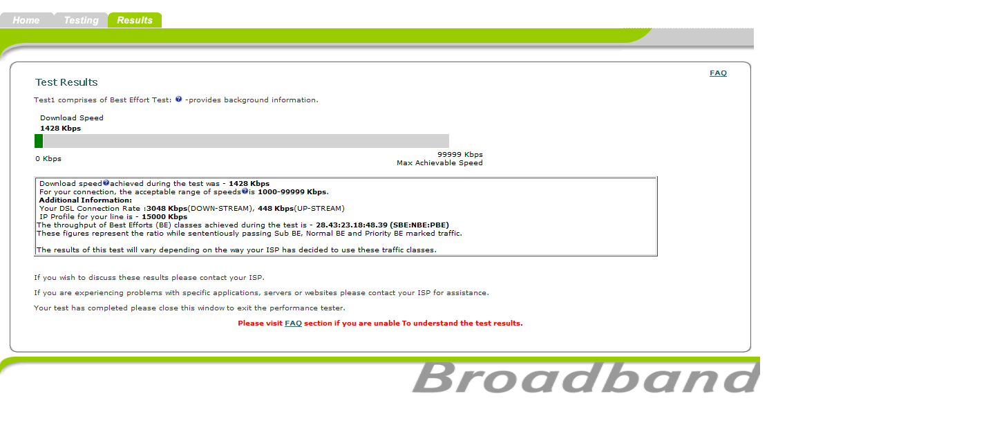

Now I have a profile of 15,000......?
Screen shot attached.....

As per our chat when I called. Please ignore the incorrect line profile on the BT speedtester. We can indeed see that your sync speed has risen but as a lift and shift has completed this does restart the max line training period so your speeds should get  closer to the 3mb mark. As mentioned an order has been raised to remove interleaving and uncap your upstream which should complete tomorrow.
I understand that you do still have some concerns that the throughput of your connection is occasionally dropping to a level where browsing is becoming very difficult and in some cases is not working at all. As the BT speed tester has not shown any conclusive evidence of this please provide us with results of a traceroute to any sites you are experiencing these problems with.

I've taken another look and none of the screenshots show anything notably wrong since the lift & shift took place. The BT Speedtest errors I wouldn't worry about, these can happen from time to time. The tracert you have supplied shows that the overall round trip was 24ms, this is perfectly normal for a tracert, the high value in the middle of it is simply because some of the core routers don't prioritise ping traffic above other traffic and can therefore appear large.
If you are seeing slowdowns at times other than peak, can you try a speedtest here and post the results? www.mybroadbandspeed.co.uk
