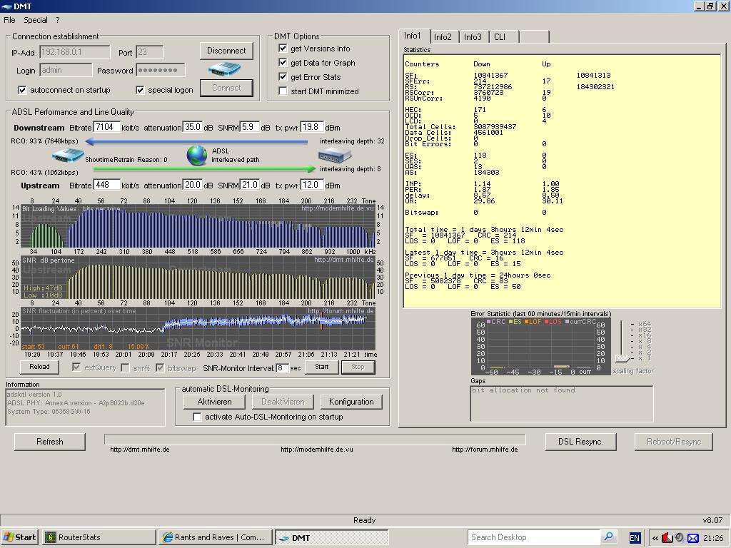

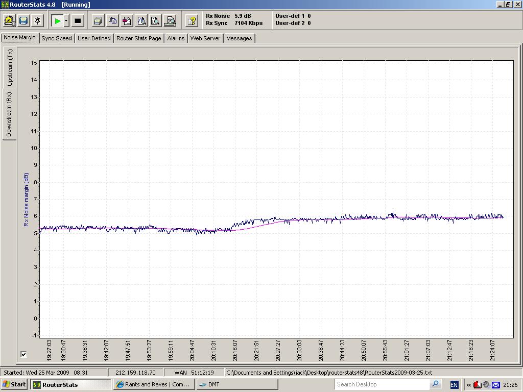

whilst the critical errors remain low and whilst I haven't done the sums on the last 24hrs in relation to traffic, the number of RScorr errors has rocketed up and is of some concern, this must be affecting throughput. Have things seemed sluggish at all?
What's causing this is the question, have you been doing anything more in the last day or so that you don't normally eg a lot more streaming or whatever? Have you installed anything the last couple of days? Have you noticed anything unusual?

No problems I've noticed, Plusnet's site is sluggish but it always is. My usage has been minimal this week so no problems there. I did install a security package (Trusteer Rapport) as recommended by my Bank, could this be the reason for the errors?, Jack.

well that's much better than it was, the RScorr rate has not proportionally increased at an excessive rate compared to last night, so hopefully it was just a one off - I don't like unexplicable events.

Edit: Hi Jack, just seen the second set, still looks ok to me.
