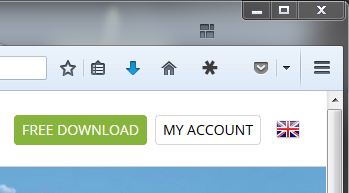

Quote from: EnglishMohican I have downloaded the cyberghost software onto my laptop. When I run the programme it puts up a screen with a big yellow button and a map. There is one of the location indicator balloons on the map and a statement "Your real location ..... " and quotes the IP number. As I type, that location is shown as in London so all is ok. On Friday, the location was shown as California.
Replicated that (attached), so I'll try and get in touch with them.
