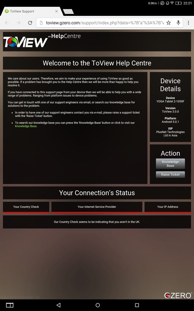

Stuntbelly
Posts: 3
Registered: ‎10-05-2016
Re: IP Address assigned in wrong region
Says I'm in India today and won't let me access uktvnow . Called toview rebranded. Wondering if a VPN would fix the problem. Something like Hola maybe
