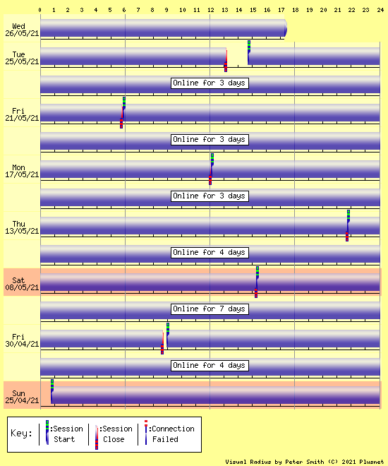

Here's how your connection's been doing over the last 30 days

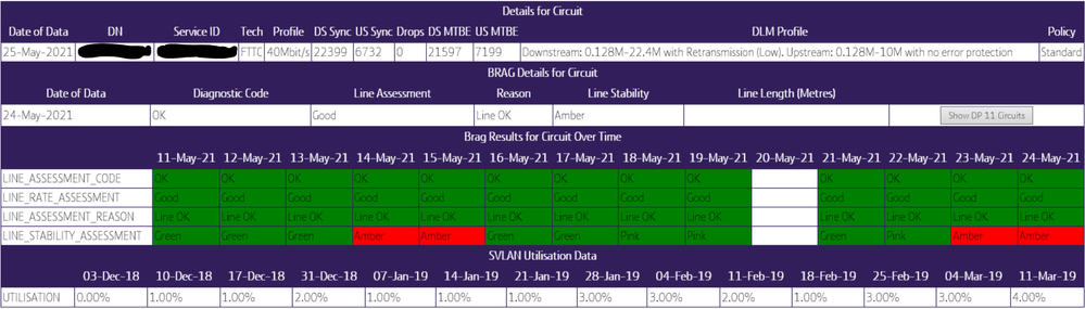

Some advanced testing below:
