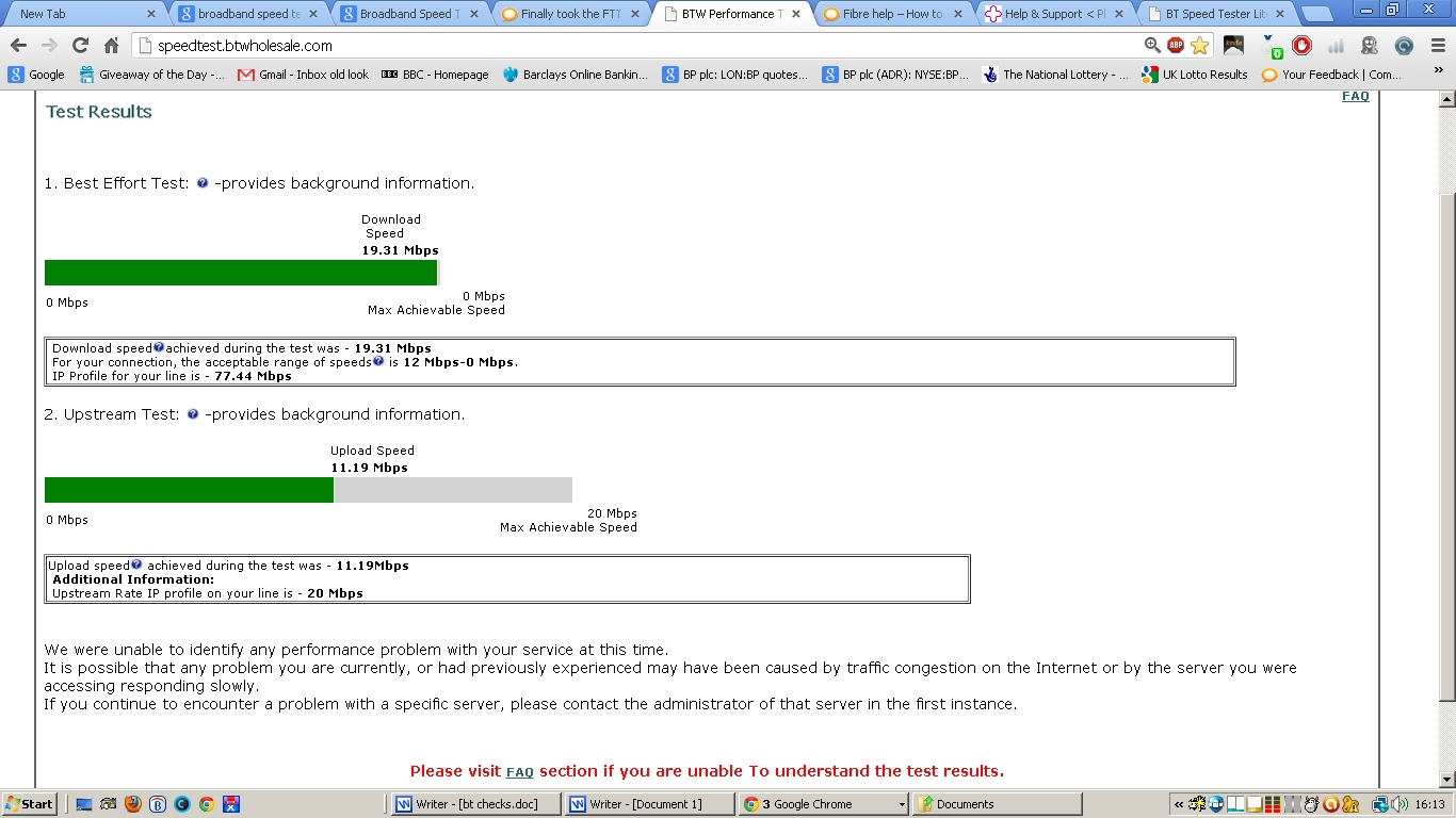

I've found a bit of time to do a few tests (including following http://faults.plus.net but not yet the PPPoE dialer).
When removing the lower faceplate of the master socket inadvertently disconnected the incoming DSL. After reconnecting I rebooted the router. (However, BTw speed test is still showing the DS profile as 77.44 Mbps).
I carried on later with lower faceplate removed (no extension wiring), plugged laptop directly into Plusnet router and did speed tests on speedtest.net - results variable, eg13 and 28Mbps downstream.
Early indications are that there could be a problem on the BT side of the demarcation point but I will do a thorough set of tests later (including PPPoE dialer) when time permits (firewall & antivirus progs off, all without lower master socket faceplate and none done wirelessly).

I've just done the PPPoe dialer test (straight into the modem) and results were:
download speed 37.2 Mbps
upload speed 5.69 Mbps
IP profile for the line 77.44 Mbps
(See attached captures)

Well that looks like something not quite right with the provisioning somewhere to me. It looks like 40/10  Huh
Hopefully someone from the DCT can sort when they are next in.

That particular result looks like 40/10 but the trouble is I did some wireless tests using an iPad and they look like 40/20 (no such provisioning/IP profile I believe).

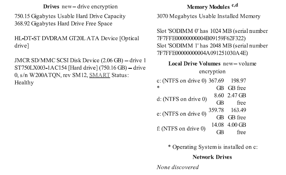

I was conversing with the Help Assistant. Ben <snip> has been helpfull so far but last night at 2.13am "Script User - Automated Script Pool" came up with "The broadband fault has been closed by the supplier. Should problems re-occur, please restart the Broadband Fault Checker."
I must object to this as my download speed is still less than half the possible 77.44Mbps. I am still in the process of trying to eliminate internal issues at my end. (See ticket 63645058 conversations).
On this ticket I attached my computer details and asked to be advised if the PC was 'up to it'. Instead, I got the reply 'case closed'.
I attach the details here. Maybe one of the forum readers can advise?
