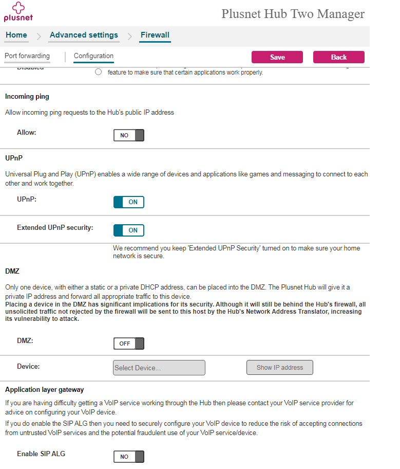

I don't have a Hub 2 or iPhones, but do have working WiFi calling, the first two things I would try, would be -
Ensure that the "Enable SIP ALG" is set to "NO", as shown below -
Change the "DNS Servers" settings for "Auto", "Primary DNS", and "Secondary DNS" to be as shown below -
Having saved the changes, reboot your router, then restart the mobile phones, and see whether WiFi calling is any better.

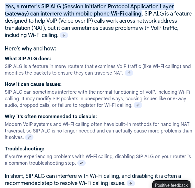

outcast
Aspiring Champion
Posts: 961
Thanks: 393
Fixes: 19
Registered: ‎11-01-2025
Re: WiFi Calling not working on iPhone
@RealAleMadrid wrote:
Don't bother with the SIP Alg setting it is related to VOIP and nothing to do with Wi-Fi calling.
Google says otherwise -
