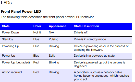

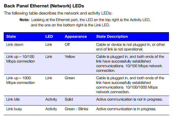

What are the front and back panel lights showing? Extracted from the manual:

Hi Baldrick1
Front light is solid blue. Rear light of which there are two close together top light is blinking green bottom light is sold green.
