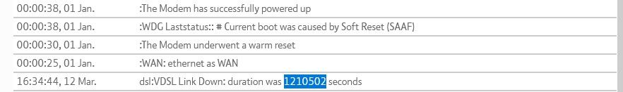

Expect a firmware update to your Smart Hub 2 to v0.24.04.11017-BT  if not already updated, then it usually boots every 14days

The 14 day soft resett happens whether you are a BT customer or a Plusnet one. This does not affect any of the settings
The settings can get lost in unusual circumstances unconnected with this 14 day event. I suspect that it is caused by the firmware crashing then automatically rebooting to start itself up again. This is a common software technique intitaiated by a software watchdog identifying that there is a problem.This causes the hub to revert to the default settings and hence lose the Plusnet credentials. I have never had this problem in the several years that I have used one but a relative who lives in an isolated location has had it happen twice. Consequently I put this down to a glitch on the mains either in the form of a surge or brown out.
If this is a regular problem I would recommend getting a small UPS to see if that fixes it.
