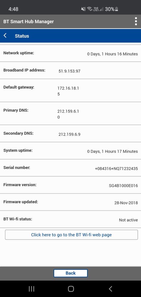

Thank you for the great instructions im finally connected but my firmware hasn't updated yet, last updated 2018, will it be stuck on that or will it update to latest firmware, my bargin of the century is this bt hub 6 for £5 lol

If you have it now saving your Plusnet username and password then switch it off using the switch on the back,  Leave it a few minutes then switch it back on with the DSL cable plugged in, check that your account details are still stored correctly then leave it alone for say 20 minutes or so as it might be updating it's firmware before coming to life.
The other possible snag is that some versions of firmware do not like special characters in the Plusnet account password. If you have any in yours then log into your Plusnet account and change it to just alpha numeric characters. Ignore any messages about using special ones.
If neither of these work do you have any means of copying pages from the hub here so that we can see what's going on?

I've done everything you advised and its still the same firmware not updatingI've done everything you advised and its still the same firmware not updating

Hi @Kel1980 Mine took nearly a week to update so I would not worry.

Ok thank you for the reply, will just leave it and see how it goes cant tell the difference in my Internet since swapping boxes over so I'm happy
