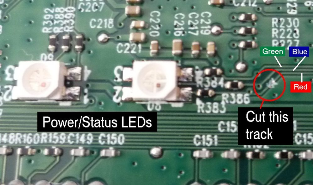

bill888
Champion
Posts: 1,273
Thanks: 272
Fixes: 40
Registered: ‎18-10-2008
Re: Using a 2nd Plusnet Hub1 as a Wireless Access point
For Plusnet Hub One and Home Hub 5A, it is normal for the broadband LED to be Red in colour, and Power/status LED to be Orange when there is no broadband connection.   The normally blue Wireless LED stays OFF too even though there is a wifi signal broadcasting from the hub.
If the red/orange lights bother you and you don't fancy sticking bits of tape over the front of the hub, a more drastic option is to open the hub and carefully cut a few tracks on the circuit board to turn off the lights permanently.
Warning: This will invalidate any remainder of the limited guarantee that comes with the Plusnet Hub One router.
Perform these modifications at your own risk !!
To open the hub, some instructions can be found in this guide:
https://www.instructables.com/id/BT-HomeHub-5A-Router-UART-Access-Hack/
Tri-colour LEDs are fitted to the circuit board.
To permanently turn off the annoying flashing Red light on the Broadband LED, use a fine craft knife to cut and scrape away the track shown below.
The Power/Status LED is Orange and is made from mixing Red and Green colours.
I've only gone as far as turning off the Red LED by cutting the track as shown below.  This leaves a shimmering Green light to give me an indication there is power to the hub (Green = 'OK').  If you wish to kill the green LED too, then you would need to cut the appropriate track.
Once the circuit board tracks have been cut, it will be very difficult to reinstate normal operation of the LEDs without fine soldering iron etc.
