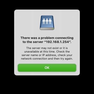

From my Mac I get the following
And on my RPI4 when I use the PCman file manager it can see all other shares on my home network but nothing shows for the Hub2. Also on my iPad I get a failure to find server error as well.
What do you see using smb://192.168.1.254?
