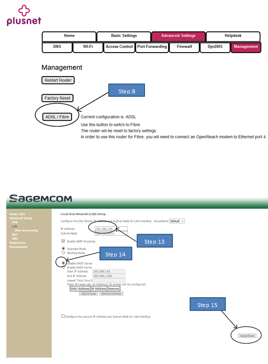

  1. Disconnect a computer from the Internet.
  2. Connect the Hub Zero directly to the computer, preferably using an Ethernet cable.
  3. Enter this address in the search field of your Internet browser. http://192.168.1.254
  4. Select Advanced Settings.
  5. Enter the Admin password and Log in.
  6. Accept the warning
  7. Select Management
  8. If set to Fibre change to ADSL. Router will reboot. This should convert the WAN port back into a fourth LAN port. Leave it a few minutes to reboot.
  9. Enter the following into the browser address field: //192.168.1.254/expert_user.html
  10. Re-enter the Password. This should get you into the Sagemcom F@ST settings.
  11. Select Advanced Setup
  12. Select LAN
  13. Change IP Address to 192.168.1.60 This will be the fixed IP address of the WAP. If this address is already in use then select another in the fixed range.
  14. Click Disable DCHP Server button
  15. Click Apply/Save
  16. Note that because you have changed the IP address the computer will lose contact with the router at the original address.
  17. To check that you are back in contact with your WAP enter the new IP address of 192.168.1.60 into the address field of your browser.
You should now have a usable WAP. You can connect this to your router using an Ethernet cable between the yellow Ethernet LAN sockets at both the router and this WAP. You will then have three Ethernet ports plus another separate 2.4GHz wireless channel at the remote location for the cost of a length of cable.

Corrections to my earlier post
Too late to edit my original I have noticed the following:
Step 3. Enter this address in the search field of your Internet browser.
Step 13. The IP address should be set to 192.168.1.60 as shown in the screenshot.
I don’t know if a kind Mod could incorporate these corrections for me?
