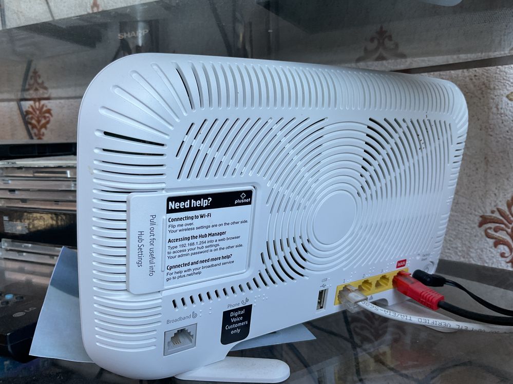

I have just noticed your edit about not needing a modem/router, but just a router with a full fibre connection. At the moment I have a wire that comes from the BT Openreach installed box that plugs into the WAN socket in Plusnet supplied Hub 2 box (I’m sorry, I don’t know the technical names for the type of wire or the connections) - as in the photograph. Are you saying I can just plug this into a router? What is all that VDSL/ADSL stuff about? I’m a bit confused as to which box I need.

EDIT: ADSL/VDSL uses a copper phone line for it's connection, something not to worry about.
