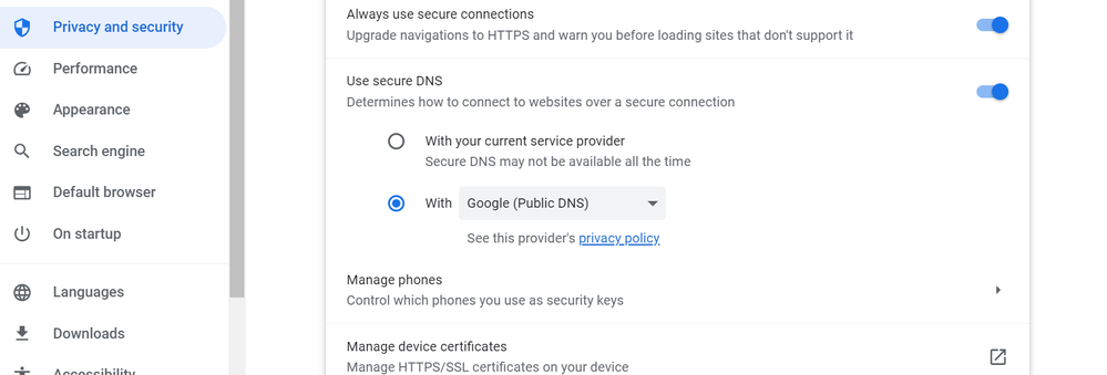

OK, the job is half done and I've set 1.1.1.3 / 1.0.0.3 as DNS in the router's settings. But the main idea was to to block malware and adult sites from loading in the browser. While ping does not resolve when using the command prompt with most xxx sites, these are still loading just fine in the browser.
Apparently, in the Chrome settings (chrome://settings/security) there is an option to enable/disable secure DNS. If this is disabled, then router's 1.1.1.3 DNS does its job and block adult sites. But if it is enabled, and something else chosen (like Google's public DNS), then everything loads fine and therefore setting 1.1.1.3 in the router DNS is useless.
Thanks again for the help, it seems I'll have to find another way to block the adult sites. And I'm out of ideas.

@Champnet i think @mrspock is referring to the fact that Chrome will override any system supplied DNS if Secure DNS is enabled. So using OpenDNS will make no difference.

There is a register entry that will disable secure dns.

but the setting is in the Chrome browser itself, AIUI it will override any registry setting.

@MisterW  Surprised by your reply as most of Microsoft options and settings are kept in the registry.
I've tried the reg fix and it does disable the secure secure on/off switch.
Now to re-enable it...................

If you click on the down arrow in the box "Google (Public DNS)" you'll see a option "Custom", click on custom and another box appears where you can enter the Cloudflare DNS 1.1.1.3
