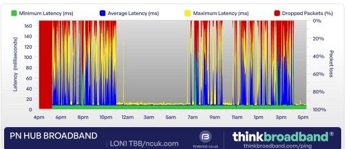

I had the basic (up to 74mb) full fibre installed last May. Connection has been fine on all my devices ,either via wifi or powerline adaptors until this weekend. Now I'm getting disconnections/buffering on both sets of devices regularly - so much so that this afternoon's rugby on TNT Sports is totally unwatchable.
I've rebooted the router, and powered down the ONT  changed the ethernet cables between the ONT and router and between router and the "home" powerline module but the problem is getting worse.
I've installed the Thinkbroadband quality monitor which looks awful to my eyes but I've no experience of using it !
Is there some way I can see from the Hub2 stats whether the issue is a failing outer or an external fibre issue?

@davidj66 Can you attach 1) The Hub event log and 2) a TBB graph showing you connection?

@davidj66 Your BQM looks pretty awful.
I'll look at the log when I get chance later, but as @MisterW is already on the job...

Have you any idea which device has the IP Address of 192.168.1.107? Could it be a gaming console?
23:05:08, 28 Mar. DHCP device Disconnected: 192.168.1.107, c4:2a:fe:13:33:25, unknown
06:31:14, 29 Mar. DHCP device Connected: 192.168.1.107, c4:2a:fe:13:33:25, unknown
192.168.1.107 is connected the eth0 - LAN1
Looking at the BQM between 23:05 and 06:30 this is when the connection had no latency.
I also note the 5GHz band is turned off?.

@MisterW ; appears to be a TV android box normally connected via powerline but ......107 appears to be it's wireless IP! Used to use it for TNT Sports but not now needed. I've disconnected it from power and powerline adaptor !

@Dan_the_Van - power to the TV and attached devices is switched off between 23:00 and 06:30 - so the Android box would be off. Now permanently unplugged.
Not using 5GHz band because some of our older wireless devices didn't like dual band and can't give 2.4/5 bands different names - worked fine with older Hub One.
In that case, my guess would be that one of those devices is uploading a significant amount of data when on during the day.
Did you know you could still use the Hub 1 if its more convenient ? It will work with Full fibre BUT has an upstream limitation of 30Mb. However that's not a problem on your 74Mb FF product since the upstream is only 20Mb anyway!
Just connect the ONT to the WAN port and it should auto detect...
NB The BQM wont work though as the Hub 1 cant be configured to respond to WAN pings.

@MisterW I would venture to suggest it isn't a guess, more a certainty, and is the sole cause.

@davidj66
Curious to know, what powerline adapters are you using, did one include a wireless access point?
Edit: BQM looks better now

Thanks for your very helpful suggestions both.
@Dan_the_Van - if disconnecting the Android box hasn't  worked I'll try the Hub One.
Will monitor the connection for the next 24 hours but the TQM graph is already looking much better.

Thanks again for all help. For completeness, removing the Android box from the local network has solved the issues. Not sure which software package on the box was d/ling so much data and why.
.I had recently installed the Opera browser because Chrome was running very slowly on the box and I'd also installed HBO Max app ready for when TNT Sports moved across from Discovery+
I don't use wireless extenders - the TP-Link powerline adaptors are 200Mb pass thru .
