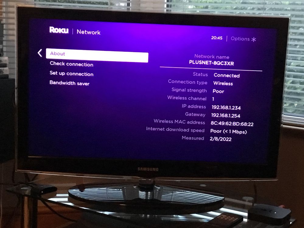

Upgraded to Fibre Plus a few days ago. The 5G signal is working fine throughout the house with speeds as advertised (66+)
However, all the devices that were working OK on the 2.4GHz signal until this afternoon - one printer, one security camera, three wifi sockets and two Roku boxes - are now unable to detect the 2.4GHz network on which they rely.
A Roku box situated less than 2m from the router can just about cling on to a "Poor" signal that's registering less than1Mbps download speed, no other device in the house can detect the 2.4G signal.
I've rebooted, changed channels thru' 1, 6 and 11 and Factory Reset the router, all to no avail.
I was watching TV via both Roku boxes and checking the security camera quite happily until this afternoon and obviously none of the wiring etc. has been disturbed.
This has to be a faulty router, right?
None of my neighbours are using channels 1, 6 or 11 according to my wifi snooping software.
2 metres away from the router...2 metres away from the router...

Update...
I re-rebooted the router this morning... the 2.4GHz signal reappeared, only to fade away over the next few minutes..24Mbps to 5Mbps to 2Mbps to zilch 🙄

Two Roku Expresses, one next to the router and the other one floor up.
The router is a Plusnet Hub Two
My wifi snooper is up on the second floor so I can't give an answer to the signal strength question from there but the signal strength on the router directly adjacent to the router is "Fair"
At the time of writing, I can see a Roku box connected to the 2.4GHz radio with an RSSI of -39dB which is very healthy.
I can also see a second device successfully associated with the 2.4GHz radio with a MAC address ending 99:2B. I think it's the security camera. RSSI of -60dB, so still not terrible.
What do you mean by 'Wi-Fi sockets'? Do you have additional wireless access points/extenders on the network, or are you referring to smartplugs?
@Dan_the_Van makes a good suggesstion regarding the wireless modes. Another thing that might offer some insight, is what happens if you temporarily disable the 5GHz radio entirely?
I can see you've had you router replaced. Happy to be proved wrong but I'm not convinced this is a physical hub fault. Be interesting to see what happens when it turns up.
