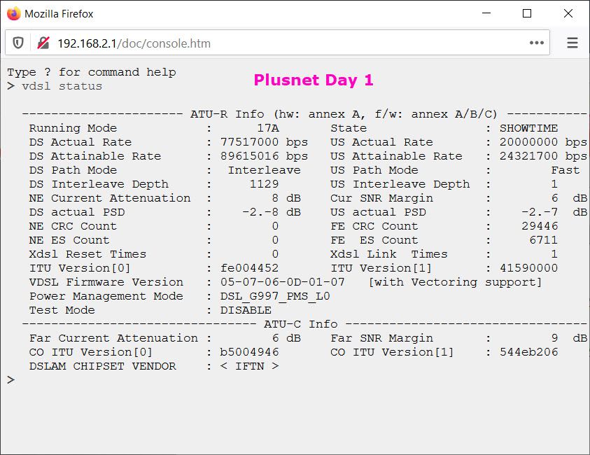

Here's my day 1 Plusnet line stats, obviously downsteam is going to be interleaved over the next 14 days while my line settles in with DLM making the necessary adjustments, although I'm pretty stoked with my line compaired to BT at present.

@Anonymous here you go, pretty impressive for day 1 👏
Re: New customer with a third party Draytek Vigor 130 modem and Asus AC5300 router
12-03-2021 1:30 PM
That's looking good.
I'm surprised that the far end error counts "FE CRC Count" and "FE ES Count" haven't been zeroed, as I would have expected that your line should have been reset for a clean start after migration, maybe that has been scheduled for the early hours of tomorrow morning.
With those line stats, your Vigor 130 should be able to reduce the "Cur SNR Margin" to 3dB, and get your downstream "DS Actual Rate" closer to 79999000 if DLM behaves favourably in the next few days.

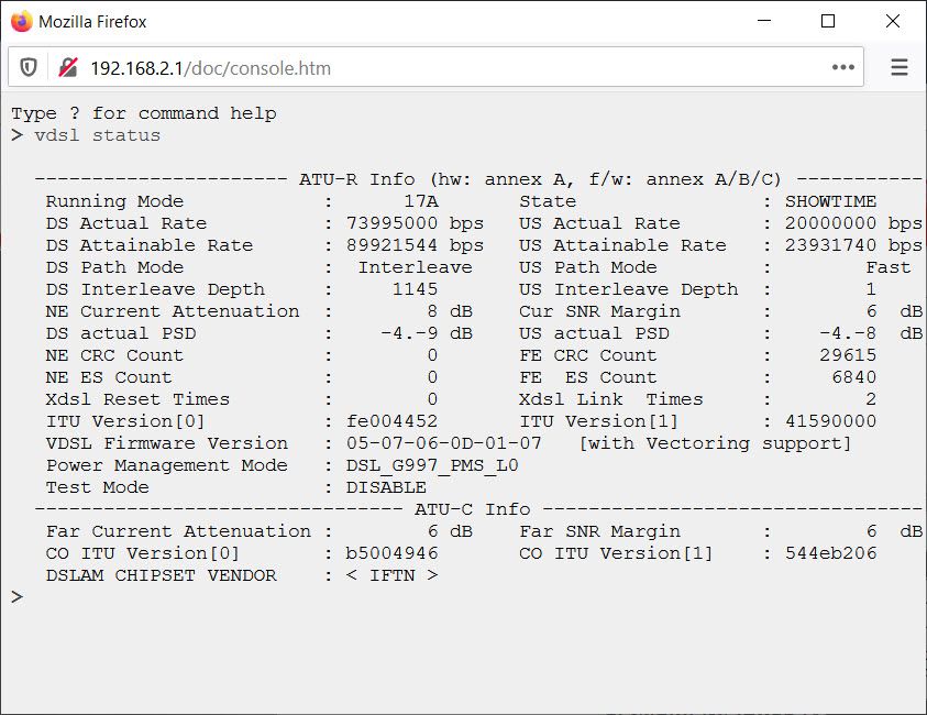

I have a question, since my switch to Plusnet on the same day as a localised power cut on Friday my line has now been reduced by DLM as attached below.
I noticed that the XDSL times is now set at 2, does this indicate that DLM has done something or has someone in my house switched off the router/modem at some point?
The reason I ask is that I have kids in my house that are on the internet until the early hours and I want to rule out someone resetting the router/modem when it will impact our line?
15-03-2021 8:10 AM
@mszune This is exactly what I said would happen in my previous post (message #24) You had a very low SNRM so DLM has caused a resync and the line is now running at the normal 6dB SNRM. That explains the XDSL link times value of 2.
What is not good is that your downstream rate is now less than you had on your first day on Plusnet and looks like it may have been banded, that is capped at 74Mbps, because the speed is almost exactly that value rather than some random number. You may find that the sync speed does not go any higher. You could ask Plusnet to check your line to see if it is banded and they could request a DLM reset but as you are already getting a good speed they will probably say you are within the expected range and do nothing about it.🙄
