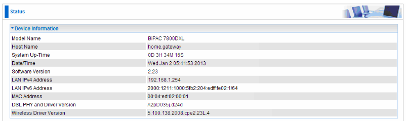

@MrPork
What version of firmware is your 7800DXL running ?
It can be found as "Software Version" on the page that looks like this -

Re: New FTTP 500Mbps
Firmware is the latest.
Internal port settings list the ethernet ports as 100Mbs, I can't set them any higher.
