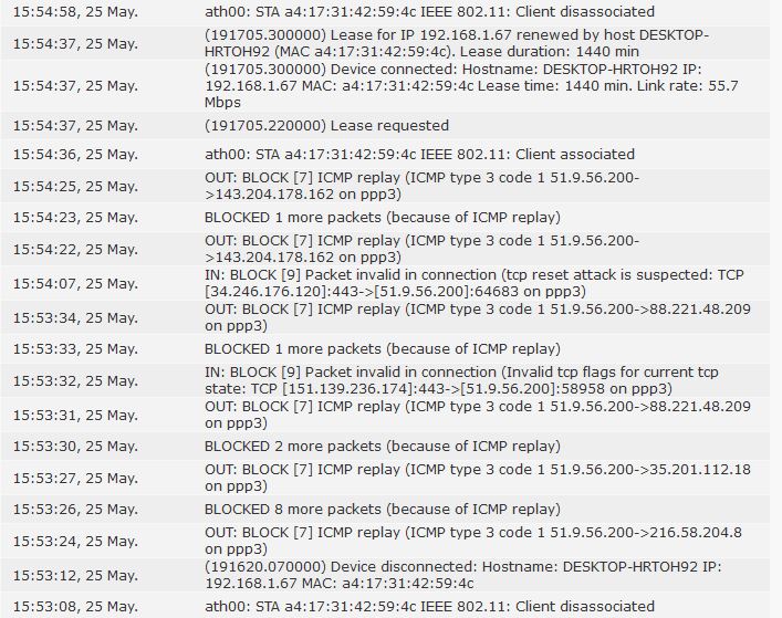

We joined Fibre at the start of the week and have had a couple of issues since, but the main one has been the connection of my laptop to the WiFi connection.
The laptop connects initially to the WiFi fine, but after a few minutes websites do not load ('Unable to connect' messages in Firefox), then the WiFi icon in the taskbar changes to indicate the WiFi is not found.
Running the troubleshooter on the connection when it cuts out displays several messages which may help. During the process, it states 'Resetting WiFi' before the troubleshooter fixes the problem by displaying 'Default Gateway is not available – Fixed' (see attached images). It is temporary as after a minute or so the process repeats.

I have attached screenshots of the troubleshooter, and from the event log when the disconnect occurs.
Any help with this would be very much appreciated. Thanks.
