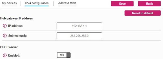

@ashrogan
First you need to connect to the second Hub two with nothing else connected with exception of a PC to make the changes
1) Navigate from the page Home >Advanced settings >My network >IPv4 configuration
Change the IP Address of the Hub Two from 192.168.1.254 to 192.168.1.1, after the change has taken you will need to connect to the Hub using it's new IP Address of 192.168.1.1
2) Once restarted and connected to 192.168.1.1 you will need to turn DHCP OFF using the same screen on the Hub Two, make sure you save the changes
Once changed the screen should look like
Connect a LAN port on the master Hub two to a LAN port on this Hub two, you need also need to ensure the PC you made the changes on connection is refreshed to it see the primary Hub as for DHCP
I would also disable the second Hub two Firewall and disable UPnP
Home >Advanced settings >Firewall >Configuration
These change are all I think is required and will allow for a second wireless network.
