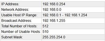

Having a bit more time for some deep thinking thoughts.
Assuming the root cause of the issue is a depleted DHCP Pool, there is a way of increasing the pool.
What I propose is to change the Subnet Mask from 255.255.255.0 to 255.255.254.0 this will increase the total number of device able to connect.

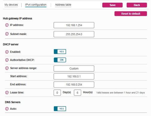

It requires  a couple of changes for the IPv4 settings on the Hub. Here you can see the IPv4 config afterwards.
There is no need to change the Hub IP Address just the Subnet mask to 255.255.254.0
To make the change I had to make the DHCP Server Start address 192.168.0.1
I left the End address as the current setting. (Edit: It is your choice of end address)
I then changed the Subnet mask.
You would need to make the subnet mask 255.255.254.0 on all devices that have a static IP Address. DHCP devices will require a reboot.

I have been coming to the same conclusion that as the Hub 2 seems to have "sitcky" dynamic IP addresses, it's causing problems with our numerous users and so a commercial grade router is probably required.
I appareicate the suggestion of increasing the pool, but wasn;t sure how to do it, so thanks for the explanation. Just a query on this - in the 2nd screen shot, would the Server Address Range, End Address not be 192.168.1.254 (instead of 192.168.0.254 ?). However, I guess this may just buy us more time and it will also eventually "fill up".
The 192.168.0.254 is the ending address of the DHCP pool, not the IP Address range. For a Hub Two in default mode 192.168.1.254 would not be included as an available address as it's the Hubs IP. For my suggestion there is no reason why the Server Address Range does not end somewhere in the 192.168.1.xxx range.
