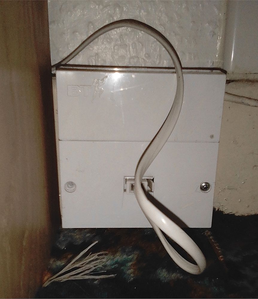

Okay, so engineer has been, spent quite a while testing our master socket and said all was fine, definitely NOT that, then came to look at our router setup / location and said it's definitely our wires/extension leads.
So, to back track and  et me try and explain.....
We live in a flat above shops. Come into the front door into a tiny hall and there is a BT Master Socket on skirting near front door. Our 3 bed flat is above a 1 bed flat (below us), so once in the hall we got straight upstairs to our flat. A telephone extension lead is plugged into the downstairs master socket, up the stairs and into our lounge, where it is then plugged in to one end of a microfilter, then the phone line and an ADSL(?) comes out the other end of the splitter and into the modem which sits on a desk next to our desktop PC. We have 2x ethernet cables coming from the rear of the router, one into the back of the PC and another lead running across the lounge and into our smart TV. Hope that's clear?
Engineer said to move router downstairs to master socket, then I said we'd have to buy and run 2 new LONG ethernet cables from the downstairs router, upstairs into the lounge, one in back of PC, another into back of Smart TV 12 foot away from PC at far side of lounge.
Engineer then said we could buy a long ADSL cable and plug that into master socket downstairs, run this single cable up into the lounge into a microfilter and that would let us keep router where it is, with one ethernet cable going into back of PC and tother into back of TV. End of this new ADSL cable should be plugged into microfilter and telephone plugged into other "hole" and we could then remove the telephone extension lead from the master socket that is downstairs and tacked up the stairs into the lounge.
Great, sounds good. By then engineer had gone saying telephone extension lead is only for carrying telephone signals not broadband.
So after I let him out, got on hands and knees to check our master socket and there is only a single "hole" to plug a telephone or telephone extension lead into.
Am I being thick or what? The end of telephone (plug) that connects to master socket is a different shape/size to an ASDL (?) plug - isn't it?
Why did he suggest that method if it's not a double master socket?
I don't get it, but basically BT Openreach are only responsible for the connection upto / just inside your property, which he tested and works fine. It's upto me to sort out cables/wires etc. I could put router downstairs but my dekstop PC doesn't have a wi-fi card and when we tried Smart TV with wi-fi it kept cutting out, hence our setup and having desktop PC connected via ethernet to router and the TV via ethernet (which is better than wi-fi, more reliable yeah?)
Any urgent help please? I need a lie down and my lunch break is over, back to work put up with the disconnects.
And why is it intermittent?
N.B. I see he hasn't screwed the other side of the master plate "front" back on, what's he done with the screw Sad
