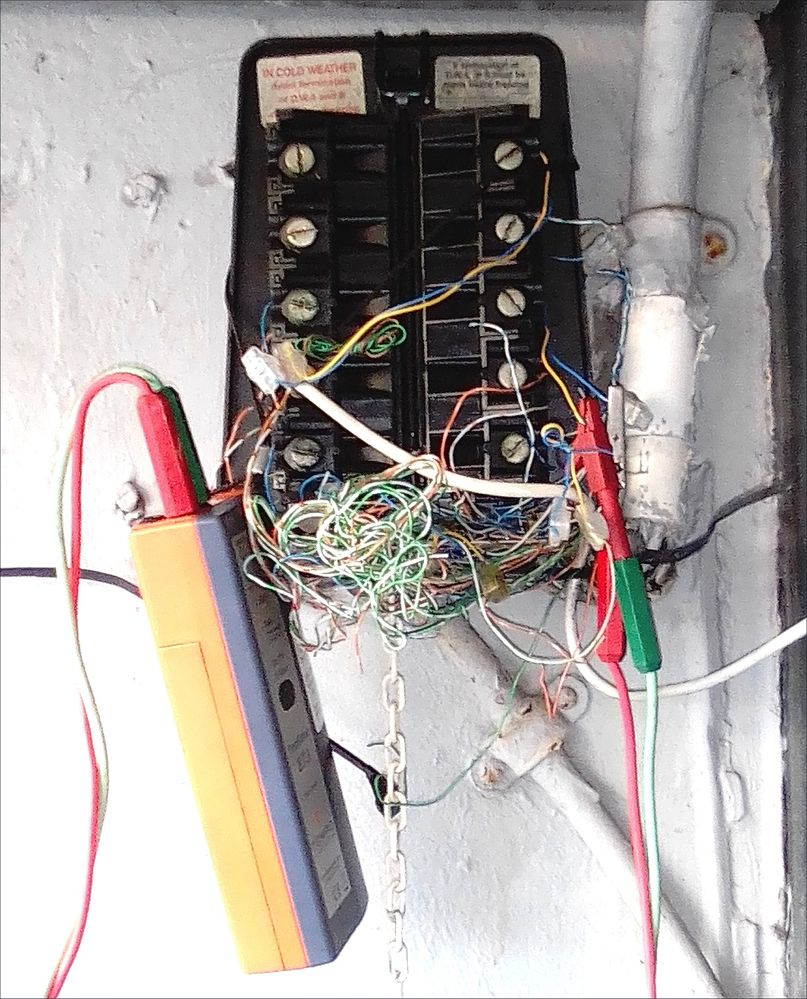

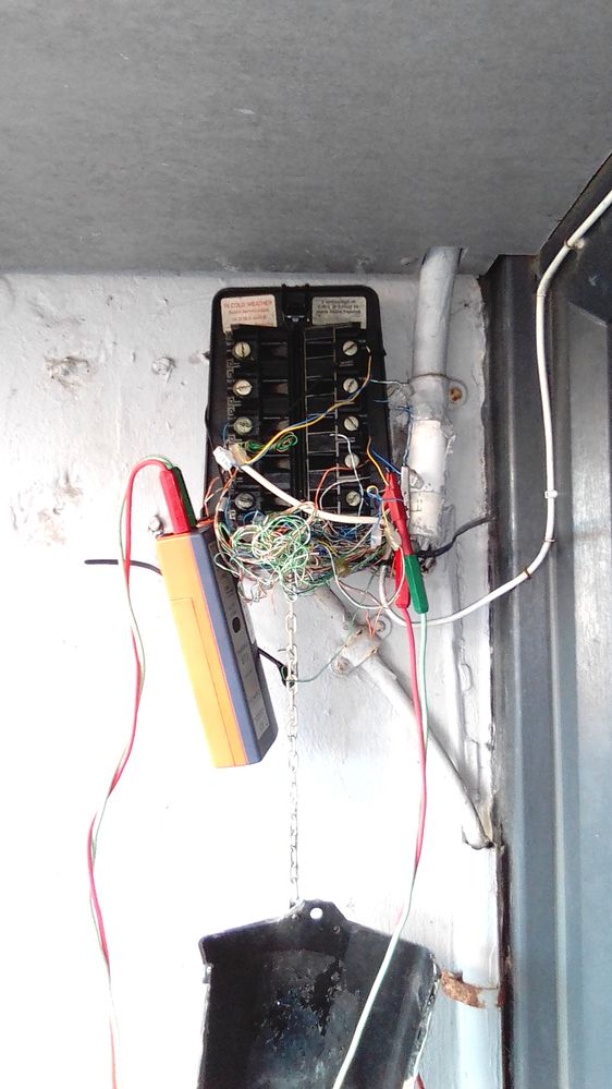

So, THIS is that BT "junction box" that provides all the wiring to the flats along this landing. Photo (taken yesterday afternoon) just shows what a total mess is it.
I assume someone else on this landing has had phone / broadband problems hence Openreach coming out and doing some tests on it, strange how my broadband started cutting out when they turned up.
I've been banging on about this BT box for over a month now and mentioned it in Post 104 way back....
Out of the 5 Openreach engineers who came, only one guy listened when I said it must be this box outside the first flat on the landing, and now here they are back again fixing someone elses problems while making mine start again. (There were all loose wires sticking out the bottom of this box before as previously mentioned).

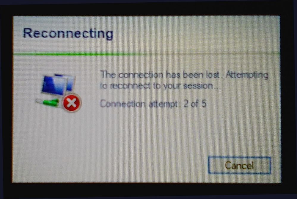

I give up, I REALLY GIVE UP.
Another "forced" 15 minutes away from my works web based software now.
Is anyone doing anything?

Had 2 text messages from an engineer yesterday saying "they were working on line now", then one later in day saying "they've fixed the fault located on my line and I should now be back in service".
Can someone please give me a heads up as to what they say was wrong and what they did to fix it?
So, it's taken 6 engineers with my problems over 8 weeks since 15th November Sad

Good morning @andyt1970
Thanks a lot for keeping us up to date on here as well. I've just reviewed the fault and can confirm that it now appears to have been resolved. The notes on the fault state that the issues was between the cabinet and the distribution pole, and was caused by general ware and tear / damp and corroded cables. The engineer resolved the fault by cleaning the block terminal.
The drops you can see on Monday are when the engineer was working on your line, though as you can see, the line has been relatively stable since. There's no need to restart your router @andyt1970
I've made @TheMightyAJ aware that you've reached out, he'll be in touch to discuss your open complaint once he's next in. Smiley
