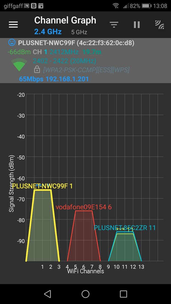

I've tried streaming again this morning and the problems have returned.
Music breaks up and is heavily distorted.
If I pause the stream for 10 seconds and restart it's OK for a short while, then breaks up again.
Any more ideas please?
Here's the channel list when it breaks up-
