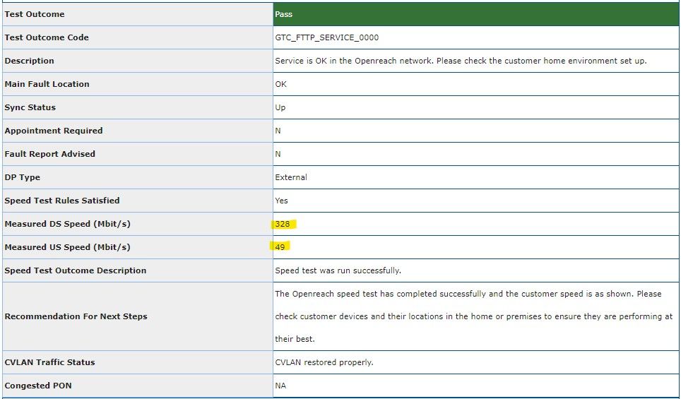

Do you know what Wi-Fi band the devices you're running speed tests from are connected to? e.g. I note at the moment that there's a OnePlus smartphone connected to the 2.4GHz radio. You're probably not going to get > 145mbps on the 2.4GHz band when using a Hub Two.
If the issues are being seen from a wired connection, then that does strike me as odd. Are we talking a failry recent-spec laptop?
The last thing I'd suggest trying before we consider regrading the circuit is to create a PPP connection on the laptop and try connecting it directly to the ONT's LAN port (thus removing the Hub Two from the equation). If this works at full speed, then it points towards something in the local environment.
I have run a speedtest to the ONT from here, and it's not indicative of any issues across the Openreach network (although seems the engineers have confirmed as much): -
