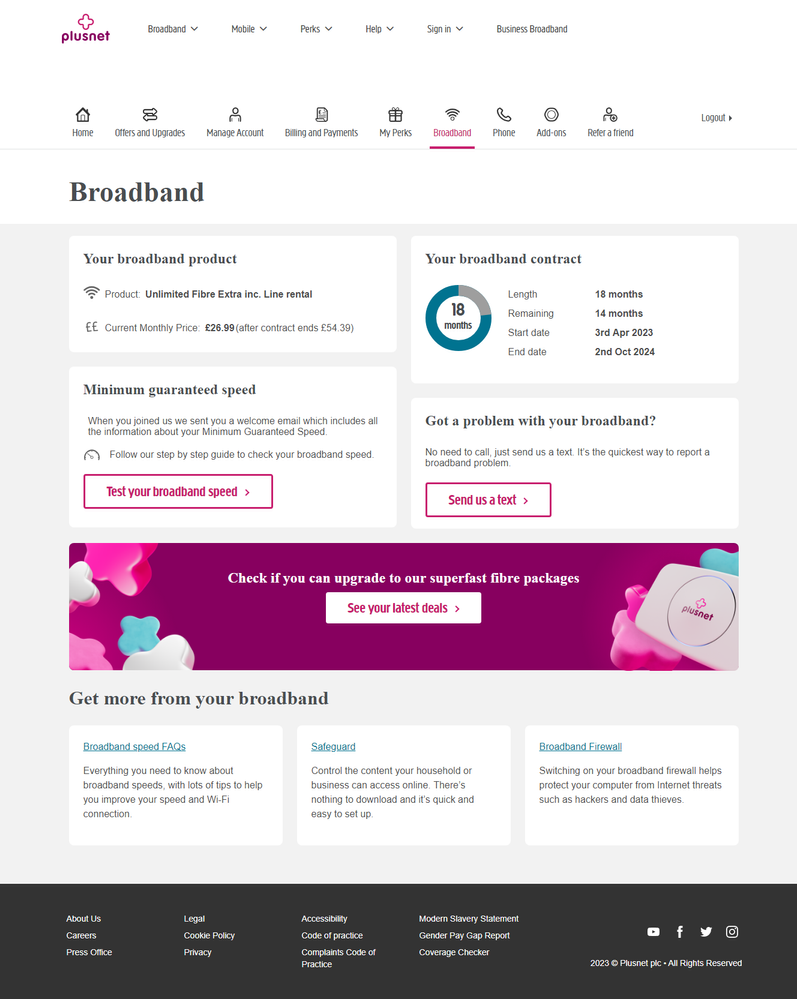

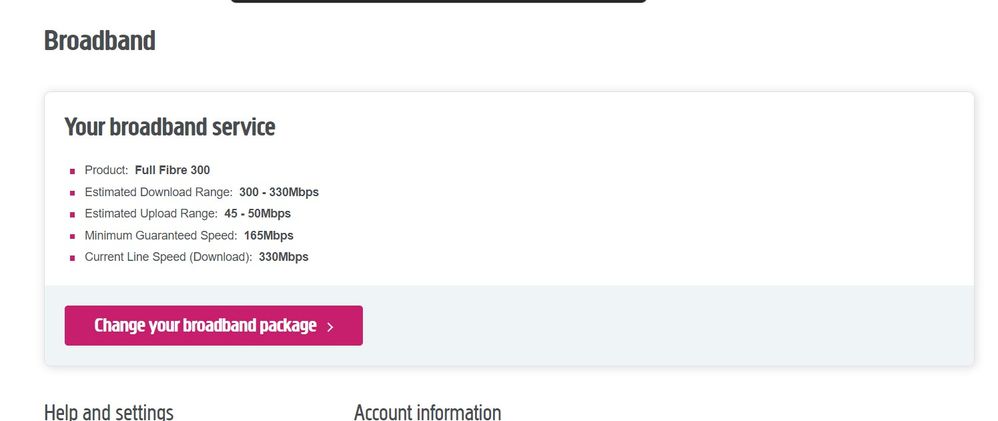

This used to be visible on the broadband tab on the member centre but the website has changed and it doesn't appear to be shown anymore.
It should still be shown here https://www.plus.net/member-centre/broadband , it is on my FTTP account

Re: upgrade from fibre to full fibre 300 but not speed no increase
@MisterW It used to be on the Broadband tab but is not there now, this page has changed for me.  There is is no info about speeds in the Your Broadband Product information.
A separate area about Minimum Guaranteed Speed refers you the your Start of Contract e-mail, I guess this is to stop all the complaints when a user's MGS  appears to be reduced during the contract. There is also a link to instructions on how to use the BT Wholesale Speed Test.

@RealAleMadrid  strange? , still shows it for me.
@MisterW, It's exactly the same for me as well.
@MisterW  This is what I get, looks to be one of the alternative webpages that Plusnet do for different customers.

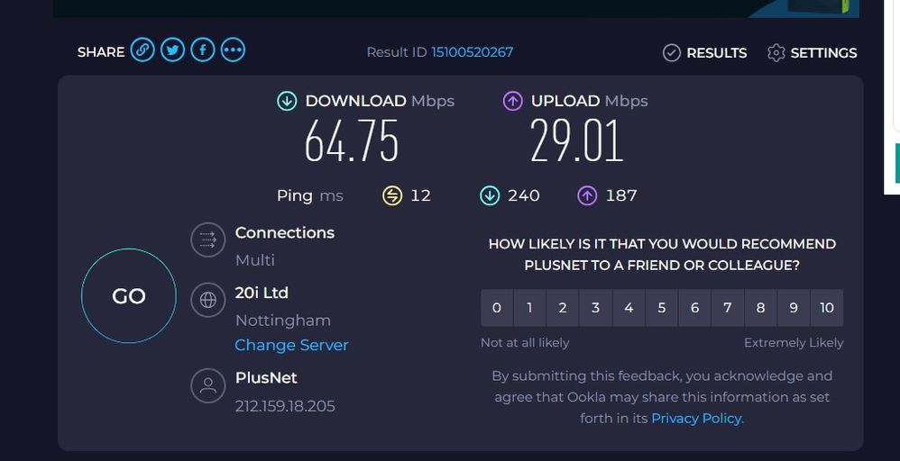

sorry for the late response,
I wasn't home yesterday. I just ran speed test
it is really frustrating, my guaranteed speed is 165MB, but my speed is only around 60-100MB, it is really based on different times, I run speed tests at around 6pm, and my speed will be 100-150MB, but when I ran it 11 pm, it only 60MB
@kangqiwang - and these are still wired speedtests?
Do you know the make/model of the network card in your desktop PC and are you definitely using at least a Cat-5e grade cable when connecting it to the hub? Have you tried a different cable? I also assume it's a direct connection i.e. not via Powerline adapters or anything like that? I can't currently see anything wired to your hub but that could be because the desktop is switched off.
@kangqiwang wrote:
... it is really frustrating, my guaranteed speed is 165MB, but my speed is only around 60-100MB, it is really based on different times, I run speed tests at around 6pm, and my speed will be 100-150MB, but when I ran it 11 pm, it only 60MB
So, you are able to exceed 80mbps down on occasion which suggests we're not looking at an Openreach provisioning/profile issue. The change I made was to regrade your line temporarily to the 160/30 service. I'm now going to switch it back to 330/50 (should complete at some point tomorrow).
