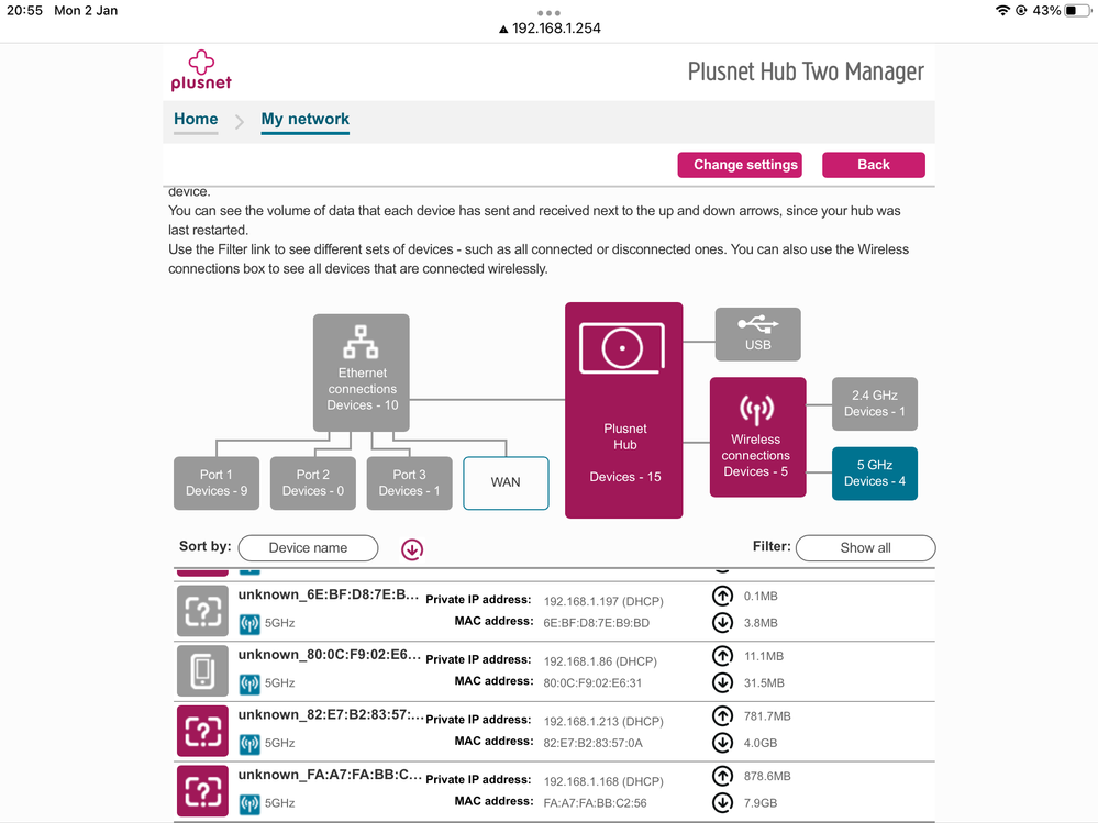

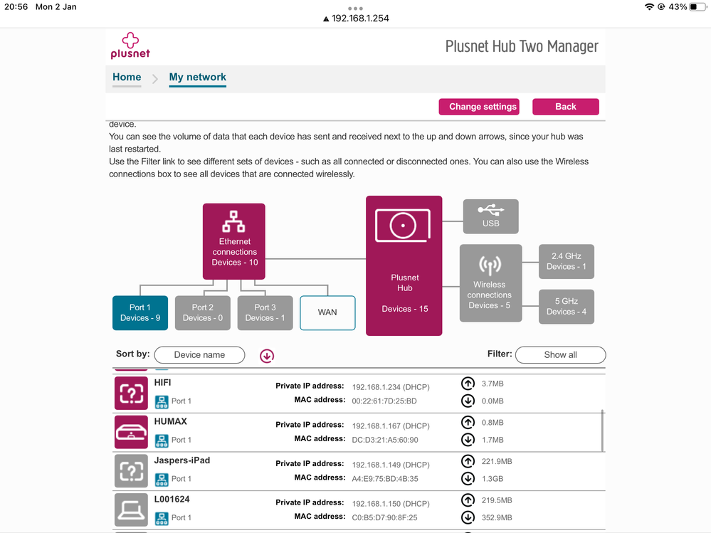

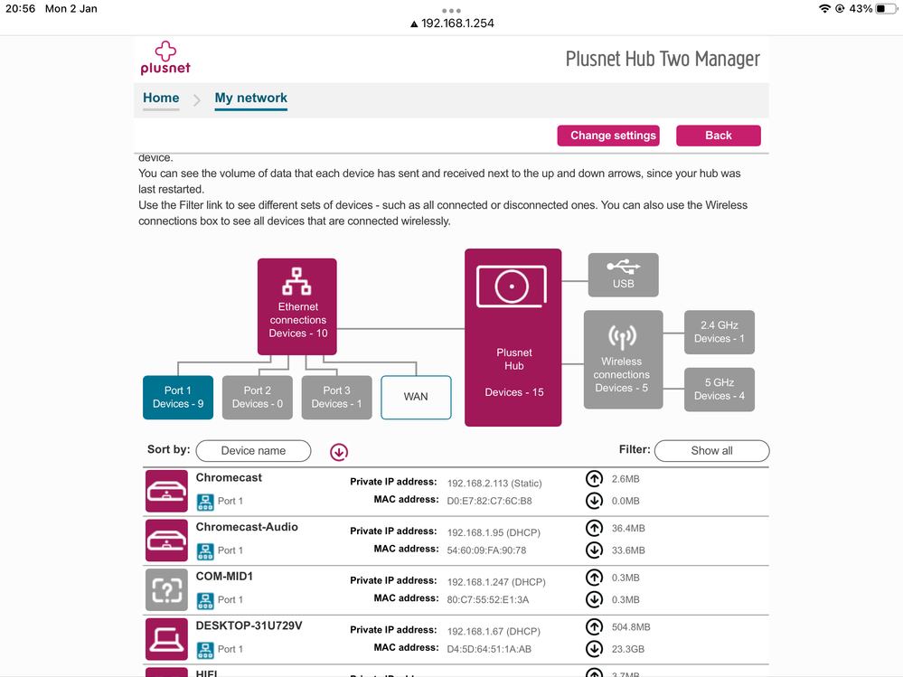

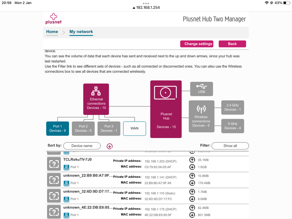

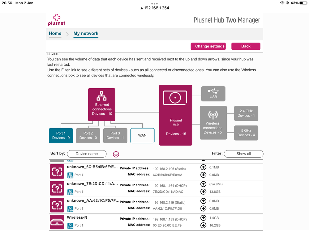

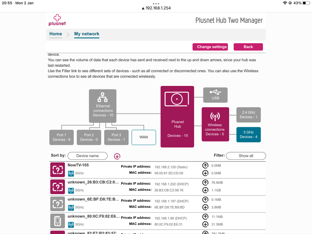

I have noticed a few times the IP address on the router is slightly different to what the device itself says.I can see the devices,as shown below,but a lot will not connect to the internet
Do you think I would be better off just buying my own router,something like a Draytek router?1899F910-9882-4A23-8F4D-772654E3C58E.png9117FAF6-2B02-4BC5-A56E-49D53360BCB6.png362EAD1E-EB16-40EA-BC23-59A604DC1F91.pngBF12071A-9508-405A-B729-6B34B1190185.pngE09BA441-466A-401C-AF5A-89906590422D.png37910541-8CBD-4EED-9428-43CCFB93C5BB.png

Your screenshots clearly show that you have devices assigned both 192.168.2.0/24 IP addresses and 192.168.1.0/24 addresses.
The Hub Two out of the box will only assign IP's in the latter range. The fact that this isn't happening suggests that there is another device on your network running a conflicting DHCP server, or something/somebody has statically assigned certain devices IP addresses in the 192.168.2.0/24 range.

I note everything is either wireless or connected to port 1.
So the question is:-  'Wireless-N' connected to port 1 on the Hub One, what is it?

There's a device labelled as an iPad with an association to port 1. Given iPads don't have ethernet ports then that's strongly suggestive that there's some sort of secondary Wi-Fi access point plugged into the Hub Two?

Wireless N is a Wi-Fi access point at the rear of the house

It would appear that the WiFi AP is running its own subnet / DHCP server 192.168.2.0/24 - Why?
If those IP addresses were only seen on Port 1 (to which the WiFi AP connects) that would be fairly OK, however a device having that IP address being seen on the Plusnet 5GHz channel is disconcerting.  Such devices will not be able to connect to the internet.
The question which need to be explored, is why do those devices have a .2.* IP address - are the static WITHIN THE DEVICE?
