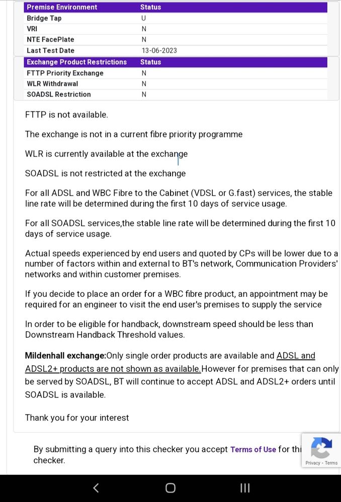

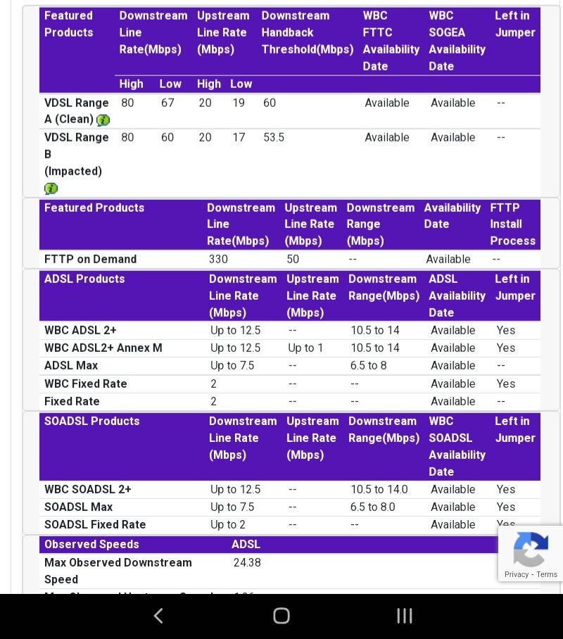

Have a look at the following. After hiding your detail can you post a screen shot including the narrative below the results window.

Thanks for the screen shot. You should get decent speeds om FTTC.
If Full Fibre was or becomes available it shows up as WBC FTTP. Internet only copper lines for FTTC are WBC SOGEA which shows up as available.
I'm guessing that as PlusNet appear to be withdrawing from providing phone services they provision lines on WBC SOGEA if available.
If A&A are your chosen VOIP provider then give them a phone to confirm everything "appears" OK for a number port. Then set up your account but do not initiate your number port. Wait until FTTC is confirmed as installed then do it. There will be a few days downtime for the phone until A&A are up and running. They appear to have good Help pages on VOIP.
