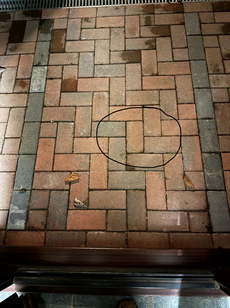

Can you post a picture of the drive as it is now whith the end of the duct (per your previous picture) marked on it. Just to give us an idea of things.
The OR call is usually just to say "I'm on my way" - I'd wait until they arrive to discuss it with them. You confirm the location of the internal ONT and that they're happy with how things look.

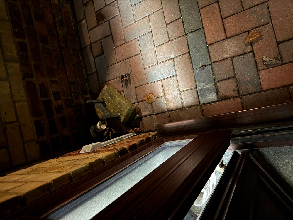

The end of the 50mm conduit ends roughly in the circled area (I cannot recall 100% the actual position)....then there is a gap of juns the cable before the 10mm conduit (if I recall about 30cm length)...all of which was under the original gravel/sand. It was certainly done like that by B.T I suspect in 1991 when the house was built.
You can see just to left in the 2nd picture where the cable just comes out of the ground and is behind a cover.
(I remember thinking I should have had a go at cleaning the 50mm conduit where the cable extruded)...I'm just hoping the workmen did manage to fit a flexible conduit with a cut like they said they would.

Thanks for the pictures.
In the second picture is there a gap in the lock block (ie a missing block) where the OR protective shield is? They need to take that off to get to the cable.
It looks to be 50 / 50 as to whether or not the lock blocks need lifting. If the pavers did indeed sort the duct the FTTP installer migh be able to rod through to the end. If not, blocks will need to come up.

@bmc There is a gap because I oversaw what needed to be done (well at least telling the pavers what and how I wanted doing) but by the time I saw the finished job I didn't see them add the conduit so I'm going by honesty...I've had that shield off a number of times myself.
I know what needs to be done, it's more I was expecting a call or at least an email from OR to discuss a survey.......I just don't see how they can expect to arrive at a residential dwelling without any pre-visit. Taking up and reseating blocks that have been professional laid isn't simple case of lift and lay.

When you've taken the proctective shield off does it sit over a duct or does the cable comes straight out of the ground?
