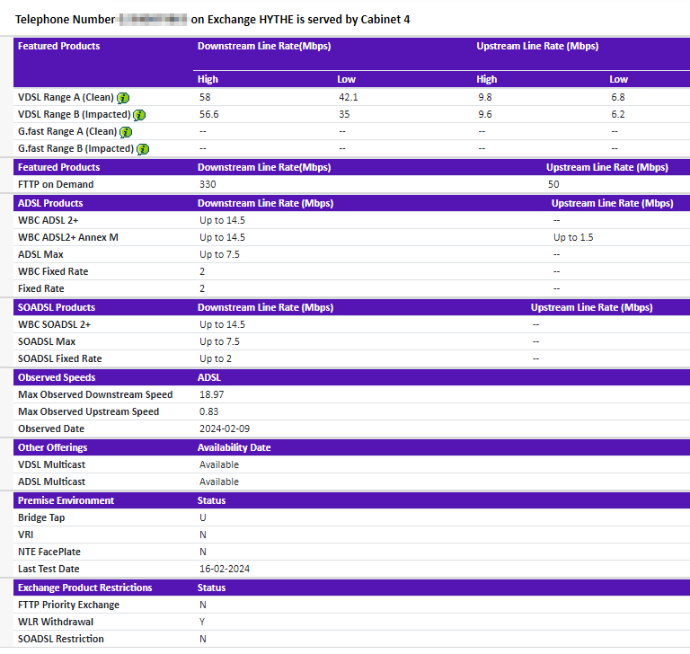

What does the Checker say for your mother's phone number. Full Fibre shows as WBC FTTP in the left hand column. FTTC is WBC VDSL and ADSL is ADSL.

phguk
Posts: 5
Registered: ‎04-03-2024
Re: How to keep a voice line with Fibre service
That link shows WBC FTTC unavailable. WBC VDSL available.
Posts: 4,978
Thanks: 1,789
Fixes: 87
@phguk
Did you mean WBC FTTP? And does it actually shown as unavailable or just not shown?

Posts: 18,437
Thanks: 7,840
Fixes: 527
I think that's just Openreach's rather obtuse way of saying that VSDL based Broadband and phone (FTTC) isnt available due to WLR stop sell BUT that VDSL broadband on its own (SoGEA) is.

@phguk wrote:
Well Plusnet clearly have some form of broadband product available with 3Mbs down [without losing the voiceline] because that's what they've insisted she sign's up for. I'm just irritated they want her to commit to 18 months.
Well they do offer ADSL 2+ but note that BT have measured the download speed at 18.97Mbps, suggesting that she should be doing much better than 3Mbps unless this is a really old legacy ADSL connection.
You have not answered my previous question on whether she was on a legacy product. You will note that the new proposed 18 month contract triggers the cancellation of her BT phone line. The cost of the line will now be embedded in the Plusnet contract without any phone service contract. In this new world the phone service has to go digital and you can't have Plusnet Internet and BT Digital phone both operating on a single line to the property.
