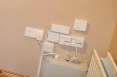

The property is indeed empty at the moment although power is (or was) on.  There's a few gizmos in the hallway but I cannot tell 100% if one of them is an ONT.  Here's a cropped image but the quality of the original wasn't great:
Not sure if the top right is the ONT?  But regardless, and given the context, an engineer visit seems like a valid event to be taking place.

@jontysoper certainly the top right is about the right size and shape for an ONT. However there doesnt appear to be any fibre connection to it. There would typically be a fibre connection plugged into the green connector and going out through the wall via an adjacent hole.

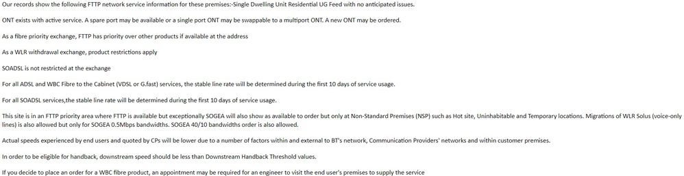

Duh, sorry, I forgot about the narrative part:
It all seems positive regarding the ONT but happy for Openreach to come along and check.  I've not yet moved in and the house is empty, so I've asked the estate agent what we can do - else I'll defer Openreach if necessary.

@jontysoper thanks for that, well the 'system' thinks you have an ONT.
ONT exists with active service.
The slightly odd thing is that it still appears the service is active ? . When did the previous occupants move out? looks like their service hasn't cancelled yet.
Given that , the order was probably placed as a 'working service takeover' but then the ONT test failed as its not powered. I suspect that the only way to progress is for the Openreach engineer to confirm the ONT is present and working, then the order should complete within a couple of days.

However, looking at the picture I can't see a power cord for the ONT. I strongly suspect when OR did a test of the ONT as part of the order they got a fault report (due to it not being powered up) hence the need for a visit.
