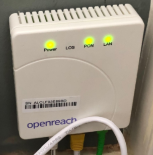

Ddiificult to say without knowing how the sockets are wired.
Somewhere in the house you should have an ONT that looks something like this
Your router WAN port needs to be connected to this .
I suspect all your sockets re wired to a distribution cupboard somewhere, probably where the ONT is where there are sockets on the other end of the cables. You then connect the router LAN ports to the other sockets. making LAN connections available in other rooms. If you have lots of sockets you may also need a network switch

I have one of those in a cupboard in my hallway. It is in a small cabinet and has something plugged into it at the bottom. There are then three ethernet sockets above the cabinet.
Where will I need to plug my router?
Re: Full fibre in a new build
22-01-2024 5:09 PM - edited 22-01-2024 5:25 PM
@Lenzar The Hub plugs into one of the sockets on the bottom of the box - I think it may be the centre one, but it will probably only fit one.
Just checked - it is the centre socket on the ONT.

Their will only be one ethernet socket on the ONT. The cable is then plugged into the Red WAN socket on the HUB2.
To use any of the wall sockets you simply run an ethernet cable from the Hub2 to the socket in the cupboard. The Hub2 has 3 ethernet sockets and you have 3 wall sockets available (a match made in heaven!!!). You'll may need to buy some short cat5e cables.
Edit : This link gives info on OR ONT's https://support.aa.net.uk/Openreach_FTTP_ONT

Right. So I need one cable from the ONT to the hub, then ethernet cables from the hub to the sockets above the ONT? I'm guessing there's 3 to go with the single socket in my lounge and the sockets that I have found in both bedrooms?
22-01-2024 6:09 PM
The Hub2 will come with an ethernet cable so that's one. You then need 3 more cables if you want to use all of the wall sockets.

It's alright, I live on my own so will only need one.
22-01-2024 6:45 PM
You'll actually need 6, 3 in the Comms cupboard connecting the router to the wall sockets, and one for each of the room sockets to connect each device
