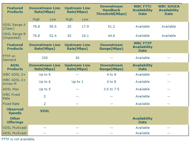

Firstly, have you looked at the DSLChecker to see what's available at your new address. As you don't have a phone line yet use the Address version, input your post code only and select the address.

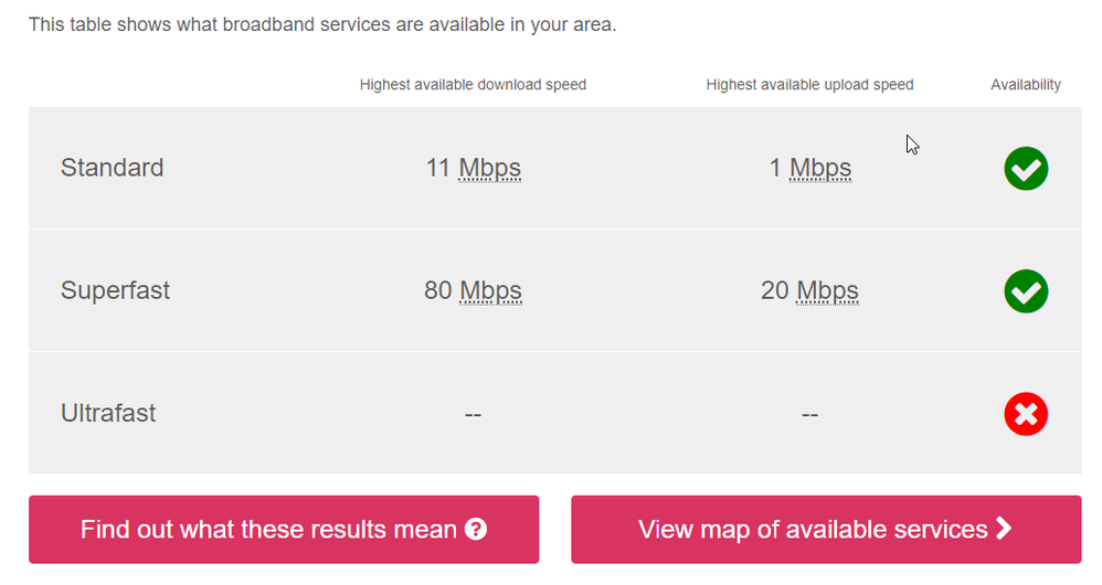

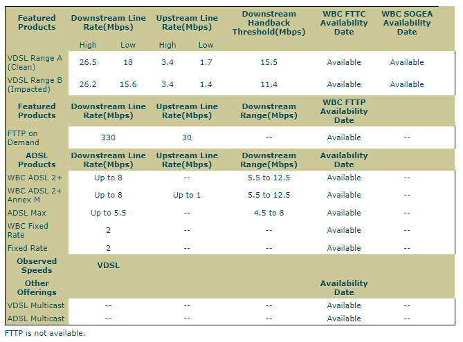

@bmc Hmmm... I'm actually disappointed! I checked the same address at https://www.openreach.com/fibre-broadband and it told me FTTP was available with "speeds up to 80mbps" - looking at the results from the dslchecker site, looks like the max I could possibly get is only 26mbps down and 3.4mbps up!? Sad
Yeah - unfortunately, the first time I went to view the house, all the plasterboard was already up. It's literally a single semi-detached house in an existing neighborhood as opposed to one of those larger new house plots where they continue to build them as they sell. If it's already finished then (and it would be underground), then I guess nothing can be done? Can't even run a cable up the wall and pin it to the brick?
EDIT: that being said, just done a check on an address 2 doors down (my address is not yet in the system, the screenshot above is next door on cabinet 12, the screenshot below is 2 doors down on cabinet 10) and they're getting superfast! Angry
That's a little annoying
