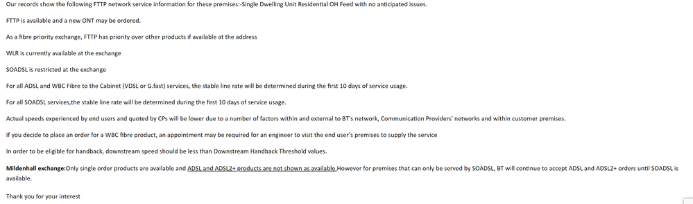

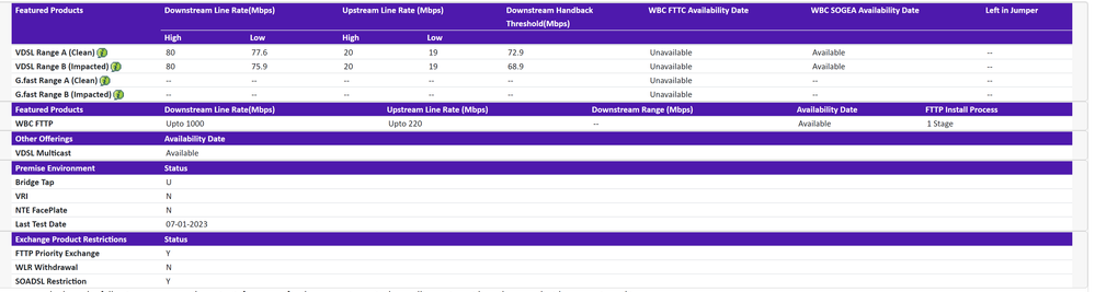

First thing to do is to check what's available at the property. Use the following
If you post a screen image (hiding your details) advice can be given on options. Your'e looking for WBC FTTP in the left hand column for a full fibre service.

Ah ok interesting, here are the screenshots:
So is this just for BT or FTTP in general?
Thanks for your help!

The PSTN service is being withdrawn so something would have had to be done about the phone line eventually (2025 at the latest). It's being done on a gradualy basis and the Exchange you're on is one of the early adopters. As sufficient fibre lines are available it's got a Stop Sell order on new copper based services. Phone services will be provided on over VOIP in future.
The Stop Sell also means you can't upgrade any existing based copper services without a very good reason and your ISP would need to submit a manual order (computer systems automatically say No if a FTTP is available).
You would / should have been able to submit an order to PlusNet for a new account on FTTP without impacting the current service. However what would happen to this when you move is unclear. If your new property doesn't have FTTP I don't know how PlusNet would have handled things.
