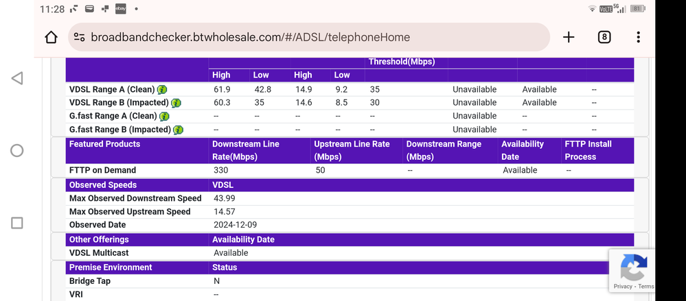

Can you post a screenshot of the full result from https://www.broadbandchecker.btwholesale.com/#/ADSL - obscuring your phone number/

About 4 years ago Plusnet offered me fibre extra at less cost than fibre, even though the speed 'available' at my address suggested a maximum of 32Mb/sec. Hence fibre extra speed would not be achieved, the price was beneficial. The result however is that I always get above fibre speed, although less than fibre extra. I liken this to saying if I choose the speed matched to my address, all that happens is in throttled down.
Although I have looked at the site you mentioned I don't see where I can add a screenshot to the list

OK - you appear to be a distance from your local FTTC cab, but sight of the result would still be interesting. To add a screenshot to a post, click the icon between the 'smiley' and 'camera' at the top of the reply window (assuming you are using a desktop/laptop) and follow the prompts.

Re: Speed with telephone line v without
05-01-2025 12:02 PM
@briston Thanks - so according to that data, you should be able to get between 35 and ~62Mb/s , and the last report on there is 44Mb/s, suggesting you have a possible problem. Which router are you using, as data from that may be useful?
