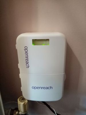

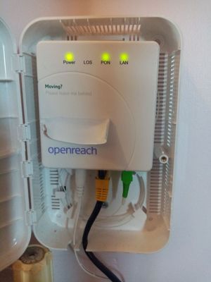

For an FTTP install they usually (but not always) attach a CSP (Consumer Splice Point) to an enternal wall. If you ask nicely (or tell them they can't so anything on the external wall) they might use something like the following indoors.
With the first the grey retangular box is the CSP.
The second set shows the box is mounted over the old Master Socket where you just see the fibre optic cable coiled behind the ONT.
It is also possible they could use the existing copper cable entry point to save drilling a new hole. Do you have power available near the Master Socket?
