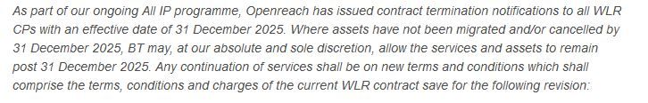

There is a lot of debate as to when PSTN will be switched off.
For the majority of users I believe it's the 31st December 2025. This is when OR plan to terminate all Wholesale Line Rental agreements. This is the product ISP's use to provide internet and phone. In exceptional circumstances OR will alow a phone service to continue. This is at OR's discretion on a line by line basis. The 31st January 2027 date is when even these lines will end - ie the final switch off.
As PN are withdrawing from providing phone services I believe they will issue 3 month termination notices by the end of September at the latest (assuming 3 months notice).

@bmc
Whilst this December 25 date has been rumoured, it has never been, as far as I know, confirmed. The latest information that I have seen simply confirms Jan 27 as the current PSTN switch off date.

@Baldrick1
Give me a bit of time and I'll find the OR web page that states WLR's go at the end of December 2025.

From ISPreview 26th March 2025 -
The big switch-off was recently delayed to 31st January 2027 in order to give broadband ISPs, phone, telecare providers, councils and consumers more time to adapt (details). But the main focus of this delay was the 1.8 million UK people who use vital home telecare systems in the UK (e.g. elderly, disabled, and vulnerable people), which aren’t always compatible with digital phone services. Take note that for everybody else, the switching deadline is still technically Dec 2025
also Openreach 23 January 2025
Phone lines and other analogue technology need to be ready for the big PSTN switch-off. We’re urging businesses to migrate off the aging PSTN to All-IP by the end of December 2025 to safeguard their services, well before the final shutdown of the network in January 2027.
Hopefully @bmc can find the Openreach document regarding residential connections, which said something to the effect of landline voice rental will end 31st December 2025, then only in exceptional cases would be allowed to continue and reviewed on a monthly basis to allow users that have specific technical reasons that so far have obstructed voice migration to quickly find alternative solutions.

So far no luck - I'm going to have to dig deep into my previous posts to find what I'm looking for. However I did find these two webpages.
https://evenetworks.com/news/wlr-pstn-switch-off-fibre-broadband-voip-sip/
https://www.thinkbroadband.com/news/10147-openreach-updated-wlr-contract-terms
