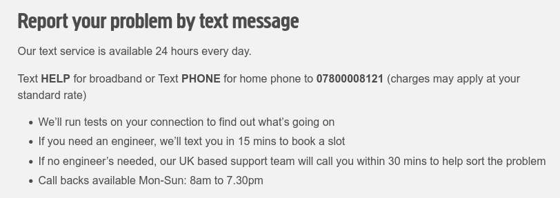

As you suspect that there *might* be an existing fault with your Plusnet phone service,
can I suggest using the mobile phone that is registered in your Plusnet contact details,
to do Plusnet's automated "troubleshoot by text" - to see whether that identifies any issues with your phone line -
