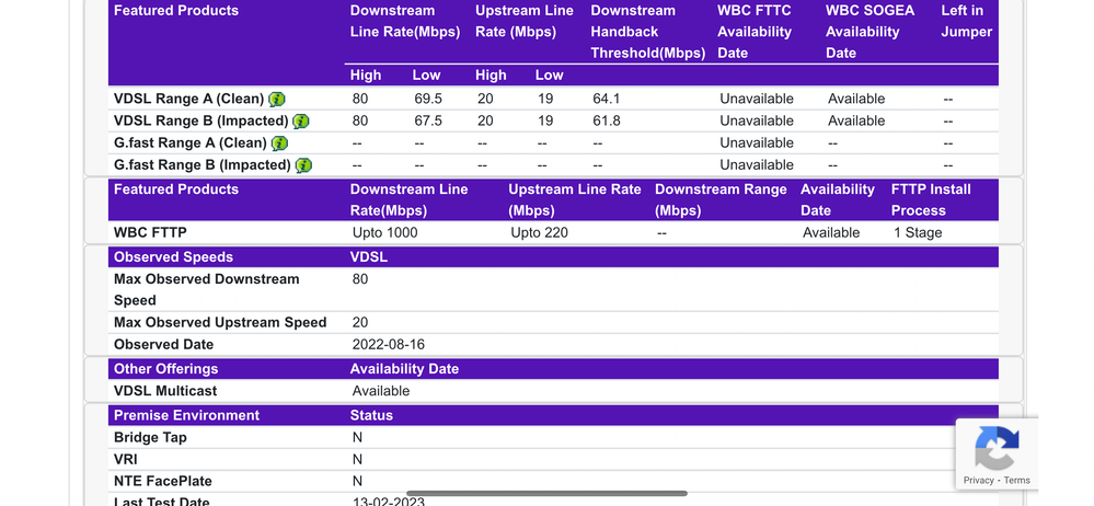

Yes I can keep me existing 36mbps fttc but can I upgrade to 66mbps fttc when go Plusnet upgrade options it only shows fttp.
Here are the results from bt wholesale.

@Minxymoo No, as said earlier, if the exchange is now Fibre Priority, no changes can be made to your FTTC provision.

@Minxymoo, just below that table, does it say anything like "As a fibre priority exchange, FTTP has priority over other products if available at the address"?

@pjmarsh it says FTTP priority exchange-Yes

Thanks for confirming @Minxymoo, as @jab1 says you wouldn't be able to change the speed of your product without going to a FullFibre (FTTP) product, which is what you are seeing online.  You may be able to phone Plusnet (Customer Options Team) and recontract at the same speed on FTTC at a different cost, but they still wouldn't be able to change your speed without going FTTP.
If you were to change suppliers you would only be able to go FTTP with that supplier.  Technically you could stay with FTTC at your current speed with another provider (as your on a 40/10 product), though I've not seen anyone advertising that they will, or anyone saying that they've been able to find someone who is prepared to do that.
