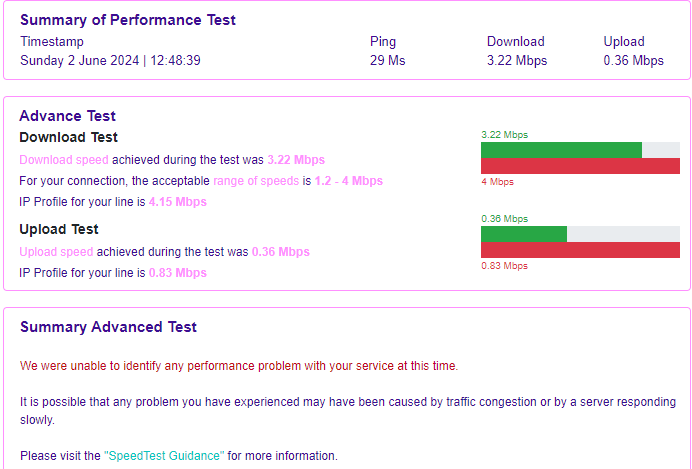

@jab1 Screenshot of Additional Diagnostic results attached.
It's poor that upload speeds aren't guaranteed; with an asymmetric connection, the upload speed is often much more critical. It doesn't make much difference what the download speed is if you have no available upstream bandwidth to send a request.

@jab1 The Additional Diagnostic worked for me, apart from the Download Report button, which doesn't appear to do anything.
Unfortunately, it is a long time since I ran the BTw test, and I can't do now anyway as I have an FTTP connection with a different ISP, but I don't remember a 'Download Report' button on there - in the days when I was on FTTC and could run that, I always just saved the report which you have attached as 'Capture 2'.
From that, can I ask  - are you on an ADSL connection, because those figures look like what you would get on a very long ADSL line, and the upload is consistent with your download?

@jab1 It seems that Plusnet could help. I finally managed contact them via X, and told them I had installed a Plusnet router so they could test the speed (which was still slow after replacing the router). They haven't told me that they have done anything, but this morning my upload speed is back up to around the 0.8Mbps mark. 😊
