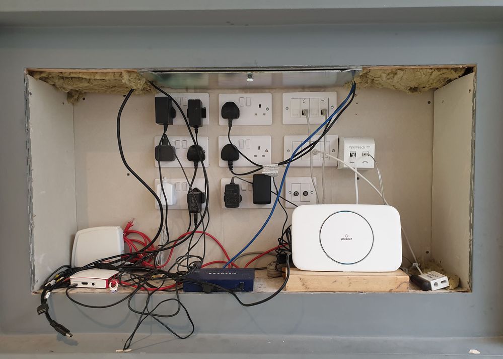

I don't actually have a Master Socket - we had an extension a couple of years ago and the sparkies ended up just hard-wiring in the phone line and we lost the BT Master Socket. I still have the cordless DECT phone connected to the landline (being ported to VOIP on 10th June and working currently) through a broadband filter - there are no other phone extensions in the house - I did the tweak years ago when we had the master socket involving disconnecting one of the wires and that made quite a difference at the time.
@robsinglehurst as @jab1 says , that's technically illegal, only Openreach are allowed to work on any connections upstream of a Master socket. You really should have a master scoket as it has a ring capacitor and more importantly a zener diode to protect against damage to the network!.
Can you elaborate on exactly how the wiring is configured now , possibly with some photos ? so that we can assess whether it is likely to be affecting your connection

So the copper pair from the telegraph pole to the house was replaced about 2 years ago as we were having noisy landline issues etc and the OpenReach engineer said that wire was looking pretty "tired". I'm not exactly sure whether we did have a Maste Socket at that point as while the extension build was ongoing the Master Socket was still connected but wasn't attached to the wall (just inside the front door) (I am presuming we did as otherwise it would have been flagged-up art that point).
We had a media wall built into the ground floor rear extension living room and my idea was that everything telephony / broad-bandy would be located in there behind the TV to keep everything tidy - with no exposed cables anywhere. I designed the sliding mechanism for the TV so it's possible to access the void by pulling the TV forward (it works really well actually and I don't lose any space by having a complicated TV mount) When they wired this up with Cat5e sockets in the extra bedrooms that were also part of the extension at some point the Master Socket "disappeared" - I queried this at the time but was assured "that it will be fine".......
I am hoping that to make this installation "correct" a Master Socket could be fitted in the media wall next to the phone connection socket on the middle right socket outlet.
Is this something that OpenReach would fit (chargeable of course) - presumably through PN?

Well neither of those junction boxes look like Openreach boxes. The 'external connection box' one under the eaves certainly isnt and I'm unsure about the one on the fascia where the incoming line is.
Normally you'd expect the incoming line to be either direct to a Master socket or possibly via an official Openreach external grey junction box at low level.
I'd start by checking the connections in the box under the eaves. Some of the external cable looks worse for wear (or is it just the photos) , is the outer covering cracked in places ?

My thoughts - for what they are worth - all those connections look rather 'suspect' and I bet they are the cause of the issues.

Only thing I would be looking at is how the OR engineer will get the fibre to your media wall so that you can kept the router there, or looking at it you have Cat5/6 points, can you use one of those and place the router somewhere else?
BTW, the phone module used may be one of these , albeit not an OR one.
