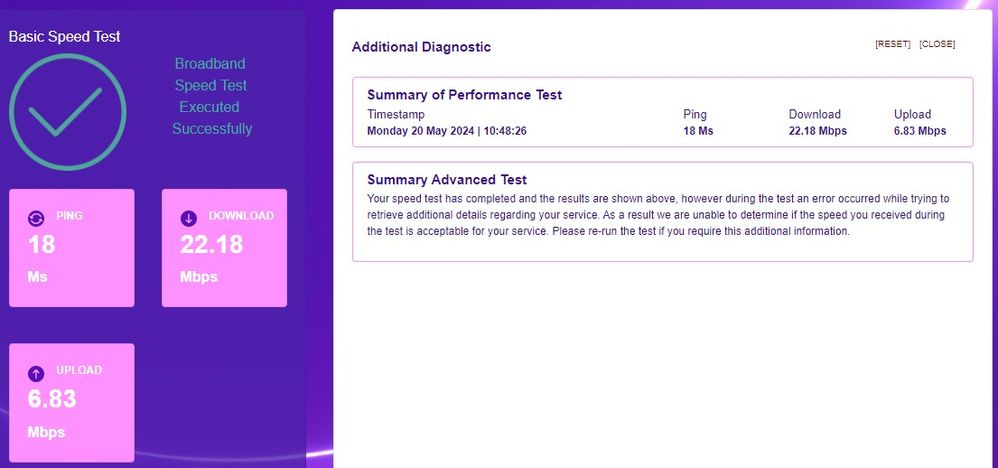

Sorry for the delay, I was hunting around for a Cat5 cable. Here are the results. Just a laptop plugged into 1 network socket (Plusnet Hub One), 2.4Ghz and 5Ghz WiFi turned off.
I ran the 17070 Quiet Line 2 test and the line is quiet - we only have a Panasonic DECT cordless unfortunately.
Guessing there is something not quite right......

Posts: 20,797
Thanks: 6,932
Fixes: 307
Re: FTTP being installed now but need to keep landline - not worried about my IP address changing.

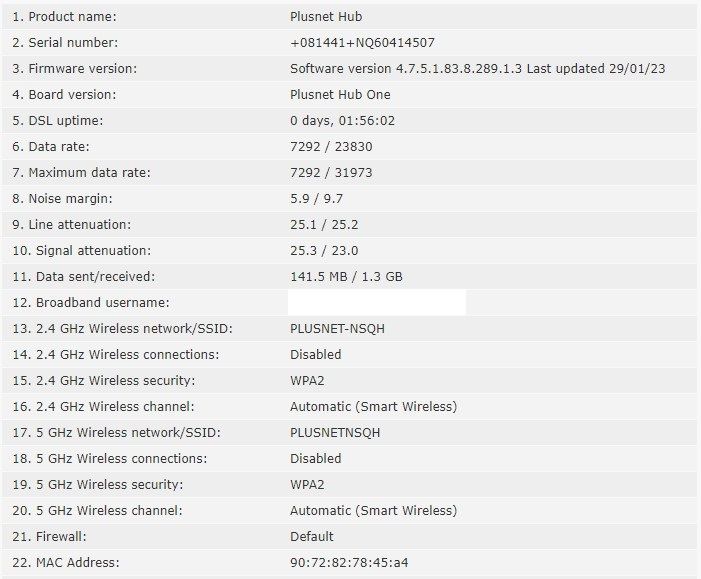

Cheers, @robsinglehurst . As you have the Hub one connected, can you please post the broadband connection status - navigate to the Help Desk page, but remember to obscure your username.
Not quite what I was looking for, @robsinglehurst - it is the Hep Desk page which gives the information   we need. It is on the 'Troubleshooting' tab.

Posts: 20,797
Thanks: 6,932
Fixes: 307
@robsinglehurst Thanks. If your phone line is silent on the test, I suggest you report a broadband fault via https://www.plus.net/help/report-a-problem/ - your downstream noise margin is elevated, indicating an OR network issue.
