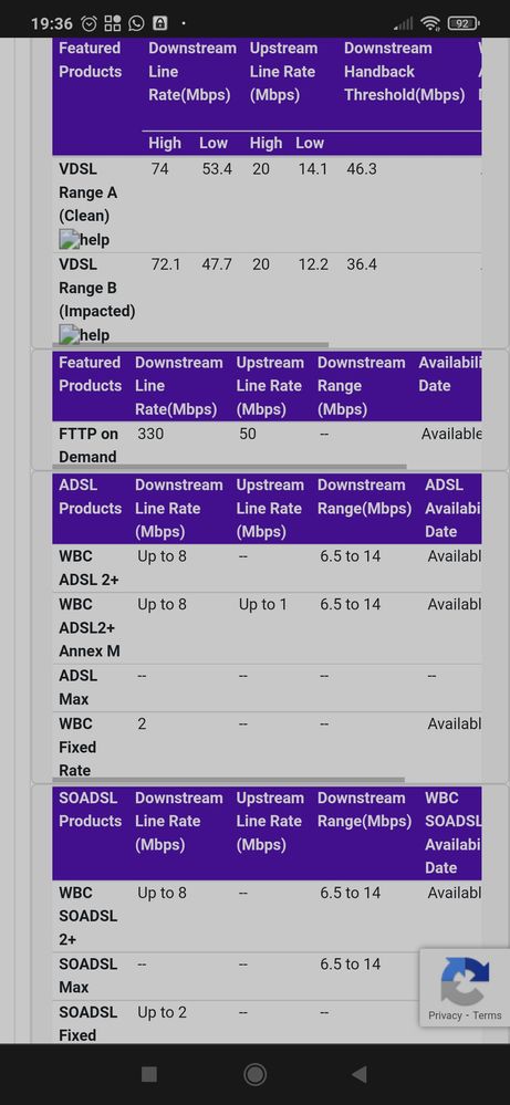

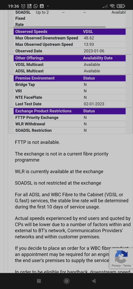

@OhWell What does BT Broadband say about your lines capabilities?

Screenshot_2023-01-11-19-36-31-156_com.android.chrome.jpgScreenshot_2023-01-11-19-36-38-561_com.android.chrome.jpg
Posts: 23,774
Thanks: 8,444
Fixes: 357
Re: Change of package mid-contract?
Thanks for that, @OhWell . It makes me think you have a problem somewhere, as your speeds should be considerably higher, unless there is a major problem with the BT/OR infrastructure.
