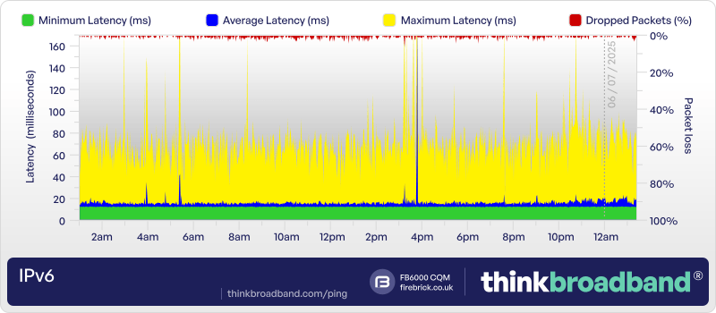

Here's my IPv6 TBB ping graph using the TG582n:

I have just setup an additional TBB ping graph to monitor my IPv6 connection, so once the graph fills up with latency readings, it will be interesting to see the difference between native IPv4 and tunneled IPv6 latency on the same connection.
For anyone interested in the effect on latency over a 6in4 tunnel on 20CN ADSL -
The TBB ping graph for my tunneled IPv6 connection has now been running for a full day, and is showing the IPv6 latency at my ADSL gateway WAN interface (i.e. NOT routed to a tunnel endpoint on the LAN side of the router).
My signature field below now has live TBB graphs for both my IPv4 ADSL connection, and the IPv6 6in4 tunnel.
I'm quite impressed that minimum latency for the IPv6 tunnel is barely any different from the native IPv4 connection.
The average latency only increases when the ADSL connection is heavily used, and the maximum latency is a bit 'hairy' but still not bad.
Currently these graphs are showing the connections without any upstream QoS.
I know my IPv4 TBB graph can look a lot quieter when upstream QoS for ping acks is active,
but next I want to find out whether it is possible to raise the priority of 'protocol 41' in the router's QoS settings.  Huh
