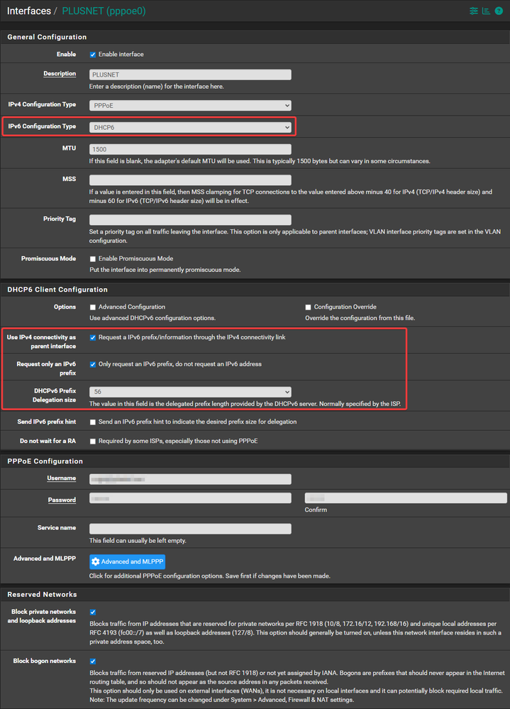

I've just had my connection enabled for IPv6 today (thanks again, Dave!), but I'm struggling to receive an IPv6 address on my pfSense firewall. I'm using the settings I used on a different ISP when I had an FTTC connection that supported IPv6, so perhaps they are wrong for Plusnet - the only modification I've made to those settings is to change the prefix delegation size to /56.

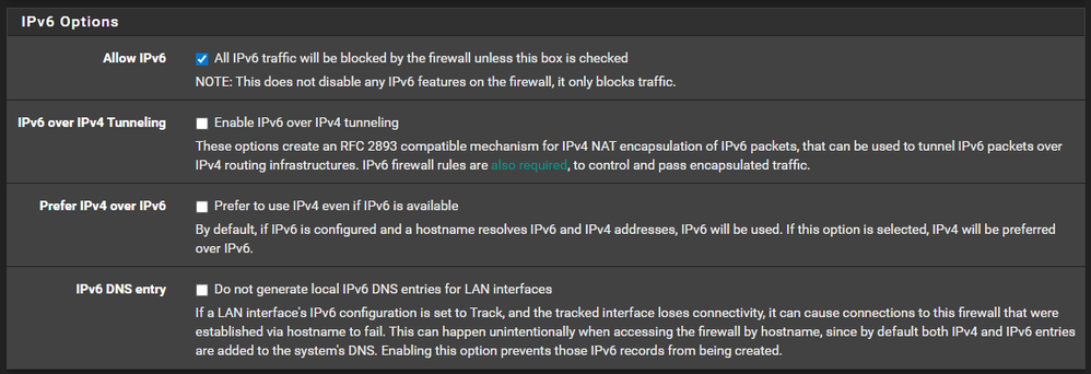

I've made sure IPv6 traffic is allowed system wide:

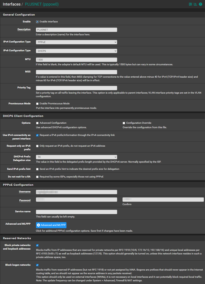

And I've used the following settings for the Plusnet interface - looking at other users' posts, DHCP6 is the correct method of retrieving the IPv6 address, and the prefix delegation size should be /56. I've also tried enabling and disabling the option to request IPv6 information over the IPv4 link, which makes no difference.

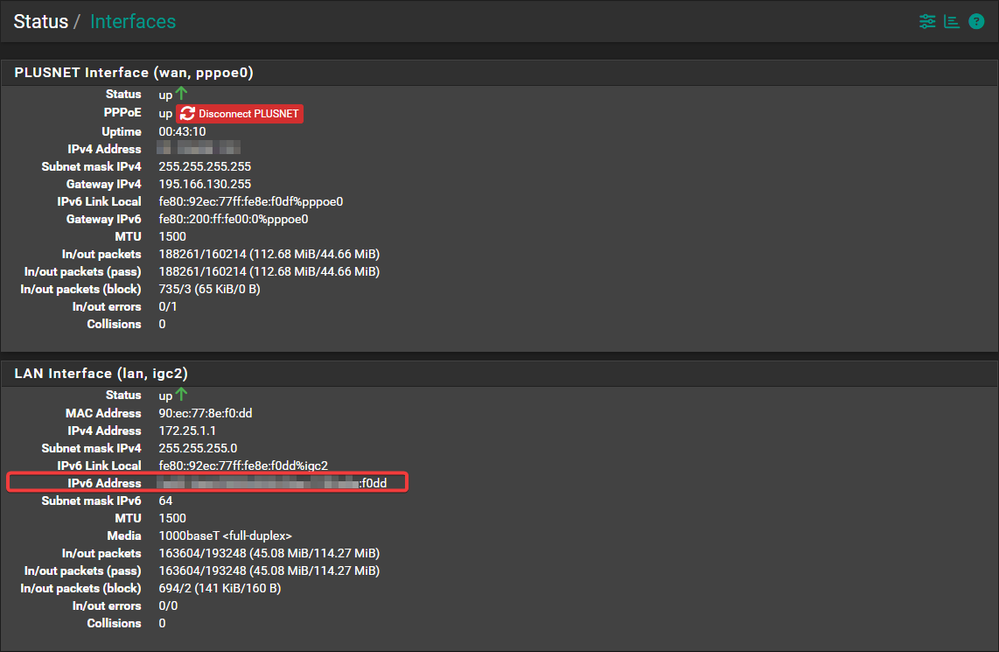

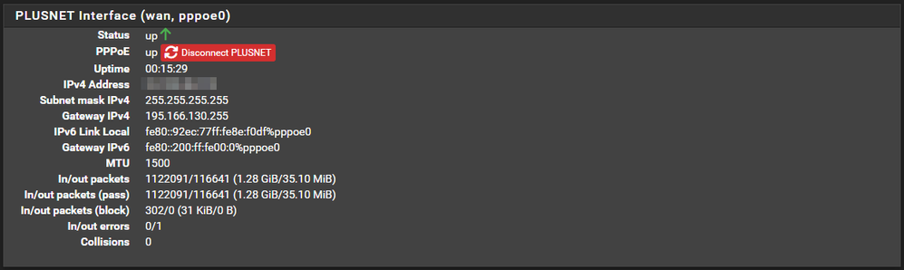

Whilst the logs aren't super detailed, they do seem to show that no IPv6 address is being assigned, only the link local address:
And the logs match up with what I'm seeing in the interface status, too:

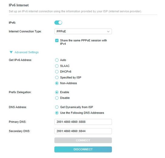

If it helps with the options, for my TP-Link AX53 I used these settings
For the LAN I used SLAAC+Stateless DHCP
EDIT: For the WAN IPv6 address I did try Automatic but it failed to connect

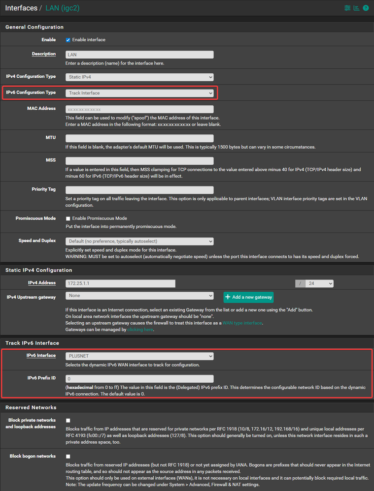

On your WAN interface, set the IPv6 Configuration Type to DHCP6, select Use IPv4 connectivity as parent interface and Request only an IPv6 prefix, and set DHCPv6 Prefix Delegation size to 56.
On your LAN interface, set IPv6 Configuration Type to Track Interface, IPv6 Interface to your WAN interface, and IPv6 Prefix ID to 0. Note, the IPv6 Prefix ID needs to be unique per interface - if you have multiple LAN interfaces (e.g., an IoT or Guest network), you should increment this number as you go. For example, my IoT interface has an IPv6 Prefix ID of 1, and my Guest interface a IPv6 Prefix ID of 2.

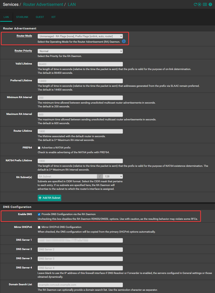

Next you need to configure your Router Advertisements setting - there are a few options if you want to use SLAAC, DHCP6, or a combination of both. I'm just using SLAAC and my firewall as a DNS server, so the following settings are for this setup.
Select your LAN interface, then set Router Mode to Unmanaged, and select Enable DNS. Leave the DNS server fields blank if you are using your firewall as a DNS server or forwarder - the top entry will auto-populate with your firewalls LAN interface IPv6 address upon saving. Note, you need to repeat these settings for each of your other LAN interfaces, if you have multiple.

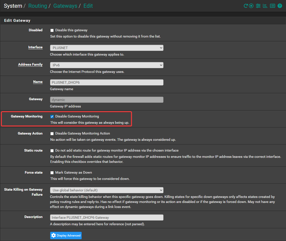

Last, you need to disable gateway monitoring on your IPv6 gateway, otherwise pfSense will always think it's down and not route traffic out the gateway.
On your IPv6 gateway, select Disable Gateway Monitoring.
Now reboot your pfSense firewall. I tried restarting relevant services, but the LAN interface never picked up an IPv6 address - only a reboot fixed this. Upon reboot, you should see an IPv6 address from your IPv6 prefix assigned to the LAN interface. If you've configured multiple LAN interfaces, they should also have an IPv6 address.

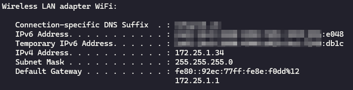

Your computer should now also pick up an IPv6 address from your assigned IPv6 prefix - mine required a restart (ipconfig /renew6 didn't pick it up), but I now have end-to-end IPv6 connectivity, which I tested using https://test-ipv6.com/.2026-01-07_17-50-46.png
