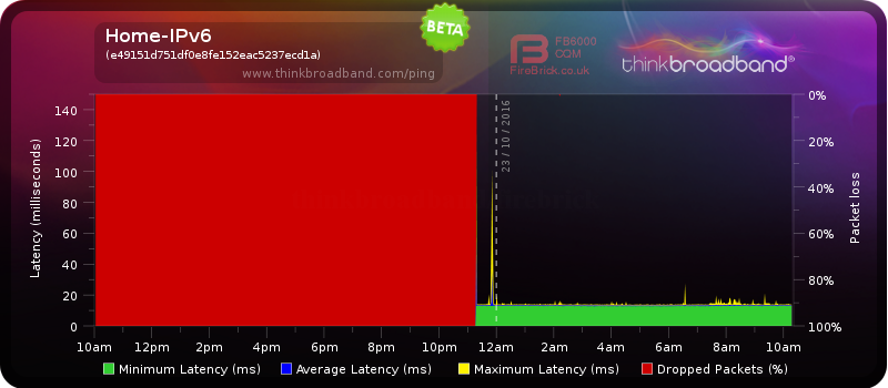

Ditto, exactly the same time. My PPP connection bounced overnight and IPv6 came back, this time I'm on ag01:
e49151d751df0e8fe152eac5237ecd1a-23-10-2016
I figure it's good to see some disruption after months of no activity. This is a trial, and the loss and recovery of IPv6 shows that someone is at least doing something with the configuration.

My IPv6 came back at approx. 23:15 last night (22 Oct 2016), I lost it again at 07:45 the next morning when my PPP session dropped and I reconnected onto a BNG gateway.
